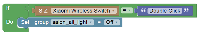

I have build a scenario, where I am using Wireless Switch by Xiaomi (a round one) + great AC Dimmer by trackerj. More on this and initial movie, showing current scenario here.
All is working fine in general, but there is a small issue.
My current blocky uses Click action to power on the lights and Double Click to power off the lights. It also uses Long Click to dim the lights, but that is irrelevant to my issue.
Here is current blocky: I would like to replace the Double Click action used to power down the lights with another Click action. So the end result would be: if the lights would be on, turn them off and if they are off, turn them on.
If I replace the current Double Click state (mind you, Xiaomi switch is a selector in Domoticz), for some reason it is switching permanently between on and off state. After troubleshooting, I have realised, Click is the permanent action and hence gets triggered all the time. So I have added the Set state to Off in the blocky you can see above, but this does not seem to be working. The Off state is not set by blocky.
Any ideas?

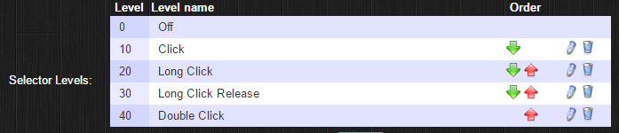

Hi Michal,

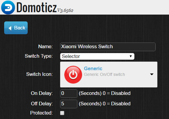

On my side, "Off" state of the Xiaomi Switch has been set up inside the selector configuration (with a 5 seconds delay) and not inside my blocky(ies).
Please also have a look, still inside the selector configuration of the selector levels order:
00 Off
10 Click
20 Long click
30 Long click release
40 Double click
00 Off
10 Click
20 Long click
40 Double click

Can you provide the screenshot or explain, how the Off state is set automatically in your case?lamouette wrote:Hi Michal,
00 Off
10 Click
20 Long click
40 Double click
In my case, I have Off state created automatically, but the Selector normally stays on the action last executed, so if Xiaomi sets Click, Click action stays. That is why, in my blocky I am trying to set Off via Set in reaction to Click action.
Michal 'Kotek', greetings from Poland. Zapraszam na mój blog o automatyce domowej po polsku: http://www.ukotka.com.

Sure, here it is :

Yes, so this is what I set, but to 1s. Yet this does not change the state of the Selector. After Click action, the selector stays on Click, does not switch to Off state.
Edit: Wait, this seems to be working now
Edit 2: I need to check the rest. If I have just Click and Double Click actions and your delay, Selector switches to off. But as soon as I change the second If in my blocky from Double Click, to Click, the Click is invoked and never changes to Off and my lights go crazy.

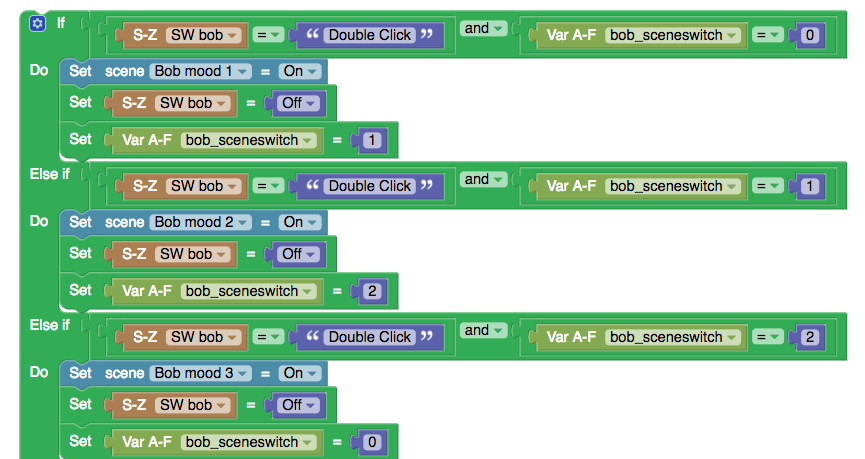

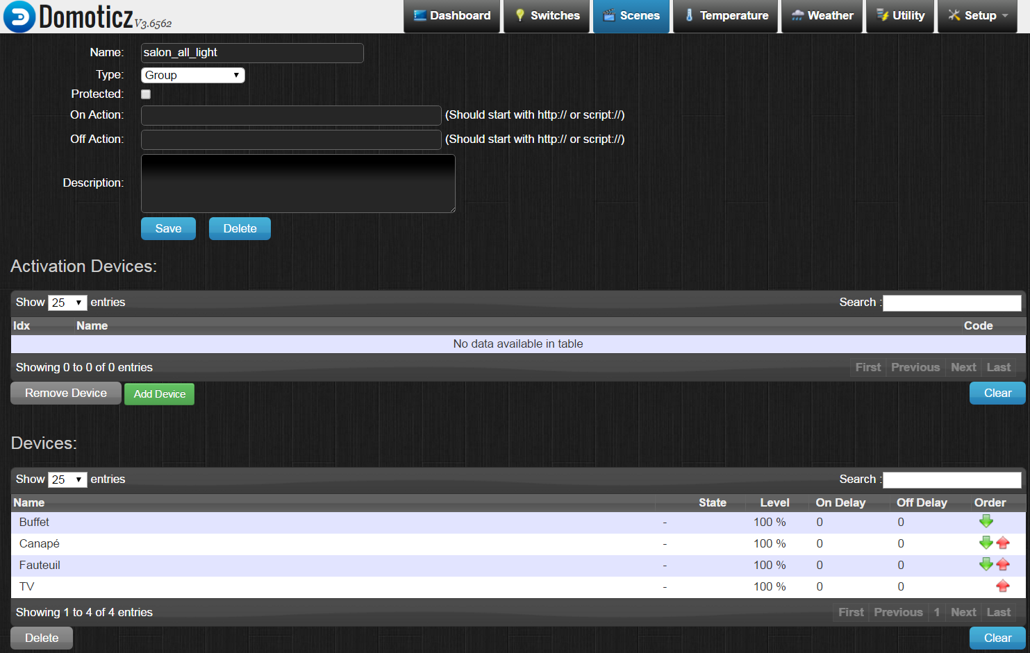

Here is my setup.
I have 2 blockies, setting up the status of a group.
I am not a big fan of "Else if"
And the scene is the following:

I haven't looked into your script yet, but can you confirm you have the same states as lamouette for the switch? -mKotek wrote: Any ideas?

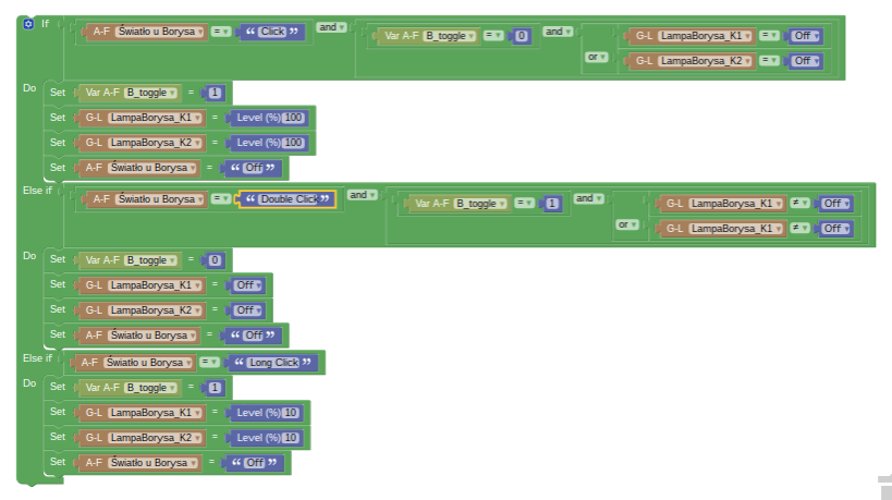

I am also not a big fan of else if, but what I am trying to achieve is to act on Click action depending on whether at least one light is on or off.lamouette wrote:Here is my setup.
I am not a big fan of "Else if"![]()
The scenario you have shown with Click and Double Click works fine in my case. I am trying to replace Double Click with Click, so that it works once to turn the lights on and then again to turn lights off.

Why don't you set "LampaBorysa_K1" and "LampaBorysa_K2" to "On" ?
Mistake on your Else If, in the "or", you check two times "LampaBorysa_K1"

I have corrected this (have missed that completely, so thank you), but this has not solved the problem.lamouette wrote:Why don't you set "LampaBorysa_K1" and "LampaBorysa_K2" to "On" ?
I have even removed the whole AND part of the second click, leaving only variable check, but still the disco lights start when only I replace Double Click with Click. Will need to debug piece by piece.
