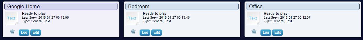

For debian-stretch I needed to add:
python-pcapy python-dpkt
01/27/2018 12:05:27 AM Starting Chromecast Domoticz detect
01/27/2018 12:05:45 AM Chromecast Bedroom now casting: YouTube
01/27/2018 12:05:47 AM Starting new HTTP connection (1): 127.0.0.1
01/27/2018 12:05:47 AM http://127.0.0.1:8080 "GET /json.htm?type=devices&rid=22 HTTP/1.1" 200 566
01/27/2018 12:05:47 AM Updating domoticz information for chromecast: Bedroom
01/27/2018 12:05:47 AM http://127.0.0.1:8080 "GET /json.htm?type=command&param=udevice&idx=22&nvalue=0&svalue=YouTube HTTP/1.1" 200 53
01/27/2018 12:07:09 AM Chromecast Google Home now casting: Spotify
01/27/2018 12:07:09 AM Starting new HTTP connection (1): 127.0.0.1
01/27/2018 12:07:09 AM http://127.0.0.1:8080 "GET /json.htm?type=devices&rid=21 HTTP/1.1" 200 559
01/27/2018 12:07:09 AM Updating domoticz information for chromecast: Google Home
01/27/2018 12:07:09 AM http://127.0.0.1:8080 "GET /json.htm?type=command&param=udevice&idx=21&nvalue=0&svalue=Spotify HTTP/1.1" 200 53
01/27/2018 12:07:21 AM Chromecast Bedroom now casting: Nothing
01/27/2018 12:07:21 AM Starting new HTTP connection (1): 127.0.0.1
01/27/2018 12:07:21 AM http://127.0.0.1:8080 "GET /json.htm?type=devices&rid=22 HTTP/1.1" 200 557
01/27/2018 12:07:21 AM Updating domoticz information for chromecast: Bedroom
01/27/2018 12:07:21 AM http://127.0.0.1:8080 "GET /json.htm?type=command&param=udevice&idx=22&nvalue=0&svalue=Nothing HTTP/1.1" 200 53
