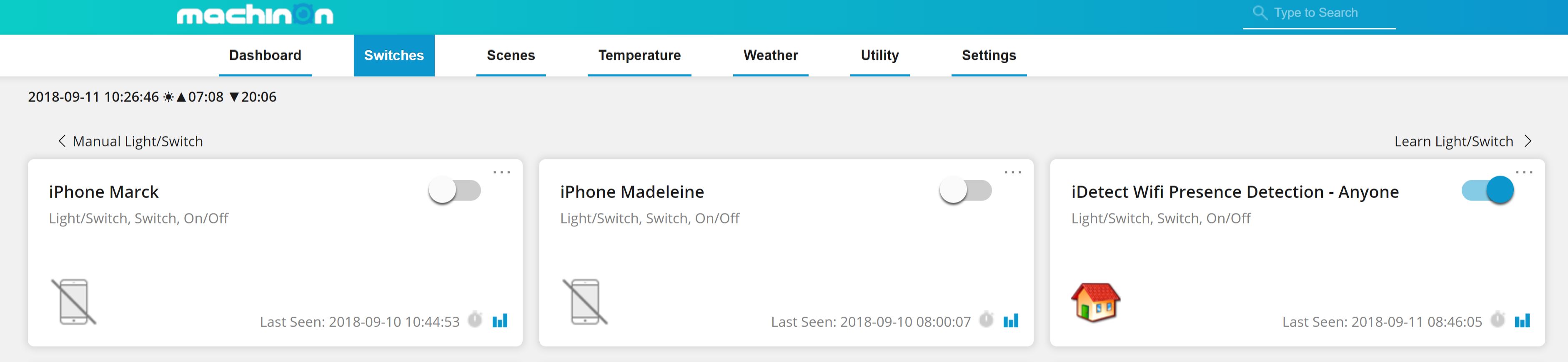

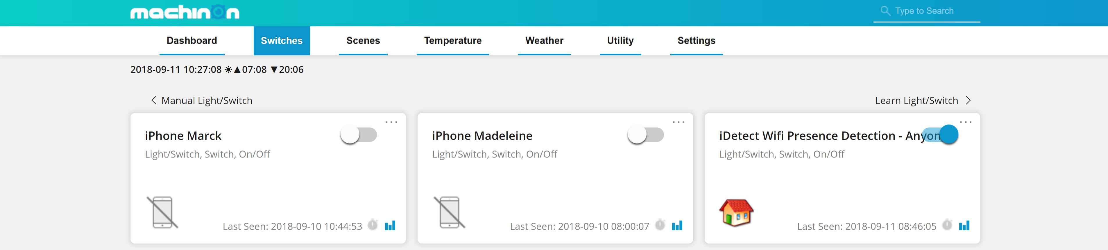

To everyone that is working on this project, fantastic job, I really like the theme.
Just a cosmetic issue I would like to bring forward.
Dashboard and other tabs resize when the refresh button is pressed. This is browser independent.
A picture makes it clear. As can be seen below, a refresh results in a
Switching tabs
Refresh page.JPG (165.05 KiB) Viewed 3088 times
Switchs tabs.JPG (168.77 KiB) Viewed 3088 times
EdddieN
Posts: 510
Domoticz version: 4.9700
Location: Scotland
Re: machinon theme
Post by EdddieN »
Yes it is a known issue: https://github.com/EdddieN/machinon-dom ... /issues/31
If you can add those screens to the issue above on github it would be great.
Thanks for the feedback! :)

EdddieN wrote: Sunday 16 September 2018 10:46 Hello,
Will do!
