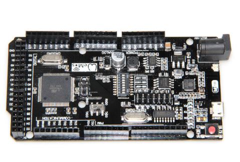

I have build the vbus sensor and connected it to arduino mega that is using a wiznet w5100.
On serial console i can see that my setup is workin OK, i get the values from my DeltaSol C 0x4212 heres a debug info:

My problem is that i cant get any data to be display in my domoticz server.
I can ping the mega on my network but no data on my domoticz server.
Can anyone help me out on this problem
This is the ethernet shield i have on my mega:

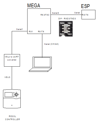

I have built my own dattaloger for vbus resol, using the vbus library, it worked fine with the Resol DeltaSol C4 and Resol DeltaSol BS , but using the same code and library for the Resol Delta Sol E generated many errors , and i can't seem to figure out why any suggestions ??

Help please i m still getting the same error values any suggestions ??

I get sucess with this board: ATmega2560 + ESP8266
And following this scheme:
At the moment I have the sketch reading 4 sensor values form Resol controller. You need to compile one firm to Mega and another for ESP8266. The first read values from Vbus to UART converter and second sent data wireless to Domoticz via HTTP GET requests
