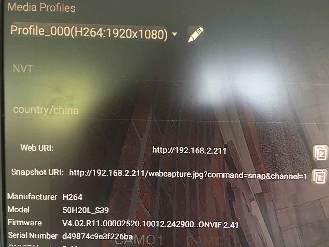

I recently bought some cheap chinese ip camera's with ONVIF RTSP support, not expecting the snapshot capability, but....... to my surprise I accidentally did find the precious snapshot link with the help of ONVIFER
https://nl.aliexpress.com/item/H-265-H- ... 4c4dSmCSlm
https://nl.aliexpress.com/item/ONVIF-P2 ... autifyAB=0
Install https://play.google.com/store/apps/deta ... ifer&hl=en (free) on an Android device and setup the camera.
Once the camera is detected, press test and the link to the snapshot stream is visible :
http://192.168.2.211/webcapture.jpg?com ... &channel=1
In Domoticz, Add Camera and fill in what is discovered in ONVIFER
IP address: 192.168.2.211
Port: 80
imageURL: webcapture.jpg?command=snap&channel=1

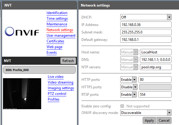

Did you use Onvife Device Manager? Is Onvif discovery mode Discoverable?

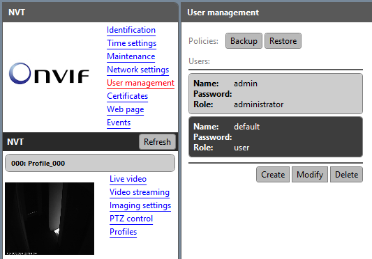

And I have a hidden user with name Default that i can see in ODM and not see in camera options

I searched for the Onvif Device Manager but for MAC there is no installable. When i download the MAC version all i get is a directory with a bunch off DLL's (looks more like the Windows version)...
