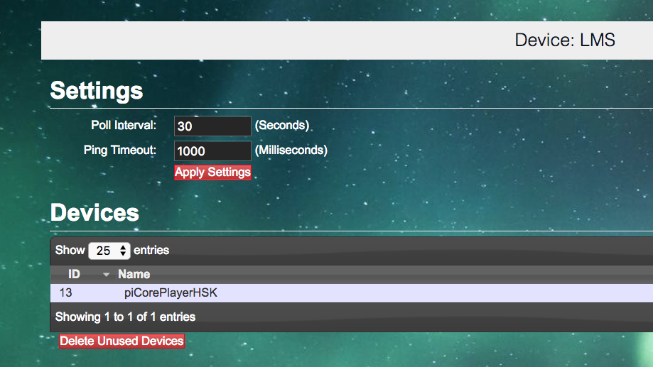

After a new installation of Domoticz, I added the LMS and it found one player, but there are no switches or whatever made.
Same goes fo Kodi devices

EdwinK wrote: Tuesday 04 September 2018 9:34 After a new installation of Domoticz, I added the LMS and it found one player, but there are no switches or whatever made.
Did you enable ‘Accept new Hardware Devices’ in Settings?

Yup, tried that several times.
I come this far now:
2018-09-04 13:56:43.545 Status: Logitech Media Server: Worker stopped...
2018-09-04 13:57:22.117 Status: Logitech Media Server: Worker started...
2018-09-04 13:57:22.118 Status: Logitech Media Server: 1 player-switch(es) found.
2018-09-04 13:57:22.203 Status: Logitech Media Server: 4 playlist(s) found.
2018-09-04 13:57:23.244 Logitech Media Server: (piCorePlayerHSK) Playing - 'Johnny Cash - 25 Minutes To Go (1968)'
2018-09-04 13:57:23.220 Status: Logitech Media Server: 1 connected player(s) found.
but still no switches
