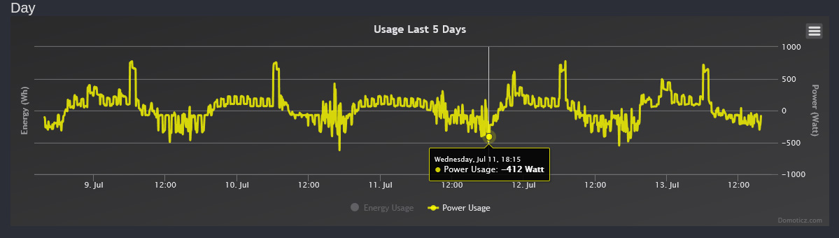

Hello, i recently adquired some solar panels, and sometimes i give power to the grid (the power company doesnt buy), since i have a pzem004T sensor (connected to a sonoff basic with Tasmota) that only knows one direction, when im giving 300w to the grid it show has 300w consumption.
I ordered a SDM120 that can see both directions, but since i havent received the SDM120 sensor, im guessing it will give negative values when im giving power to the grid.
Is there any way to:
- set the negative values to Zero
- Send the negative values to another virtual sensor, so that i can know how mutch im wasting.
- (or) like the (i think) the P1 hardware shows usage and return on the graphs.
Power usage, with negative values, due to sending power to the grid
Screenshot 2018-07-06 14.43.29-Recovered.jpg (86.62 KiB) Viewed 3016 times

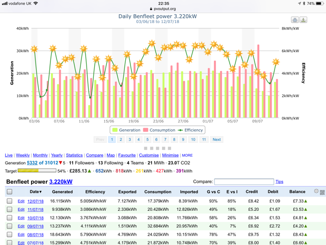

I collect my generation data from the panels and my energy consumption then use this method to upload the data to PVOutput.org: http://www.domoticz.com/wiki/Upload_ene ... o_PVoutput
PV Output then calculates the export figures from the data I’ve provided and it is all stored there.
