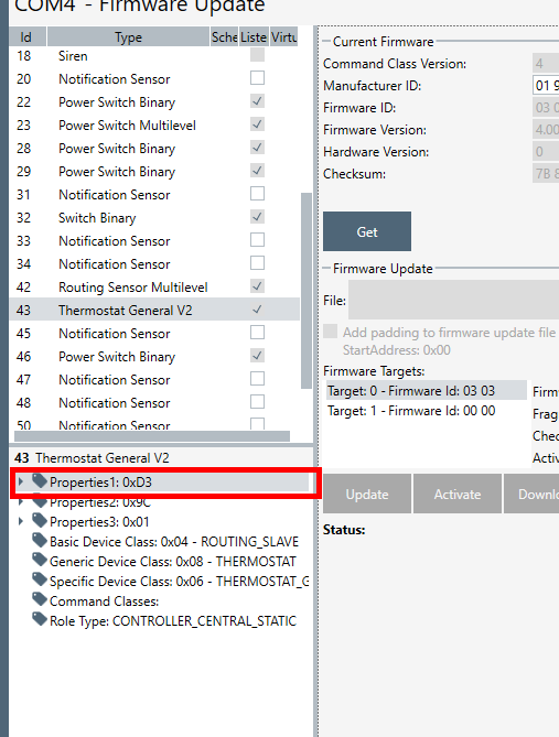

madpatrick
Posts: 760
Domoticz version: 2025.2
Re: Heatit Z-wave thermostat
Post by madpatrick »
I'm using this version
https://github.com/Cyberwizzard/open-zwave/tree/master
Which firmware do you have ?
Check out this website
https://www.hjemmeautomasjon.no/forums/ ... ment-90958
stephanvdplas
Posts: 76
Joined: Wednesday 13 February 2019 18:09
Domoticz version: 2023.1
Post by stephanvdplas »
Alas... one step further, but not yet there.
This parameter 9 (Heating setpoint) now works. I can read and set the setpoint and it actually sets it on the thermostat.
The devices that are created are shown here:
There is one setpoint, but it does not reflect the current setting. It also doesn't work setting the thermostat.
How can I create a device for the parameter 9 value?
- Running LMS, Domoticz and Dashticz on a windows 11 laptop.
- LMS (11 players) / Hue (26 lights, 2 switches) / Z-wave (14 devices) / Toon (unrooted) / Chromecast
madpatrick
Posts: 760
stephanvdplas wrote: Wednesday 20 December 2023 20:11 Alas... one step further, but not yet there.
Your device 2042 should work and change the setpoint.
Have you checked your firmware?
There is a known issue with setting the setpoint with the default firmware

I've tried with my backup stick.
In the first few attempt id also didn't get an connection with the device.
After a few time some how when (connect and disconnect USB and restart PC controller) i pushed the get button is saw in the footer some action the boxes were filled with infomrat and i could select the file.
SOmetime it helps to have de device very close to the stick
madpatrick
Posts: 760
I tried it again and nothing happend
When i click on "Properties1" and then push GET it worked
Don't forget to push first on the "Wheel" and "Detect"
2023-12-21 19_26_45-COM4 - Z-Wave PC Controller.png (44.15 KiB) Viewed 10813 times
