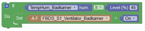

In my bathroom, I have a fan, connected to a Fibaro FGS223 Double Relay. On the dashboard of Domoticz, I can switch the fan on and off.
However, I would like automate this, by creating an event which switches the fan on when a certain humidity level is reached/exceeded. So,
I created an event:
However, nothing happens. The fan is not switched on (regular humidity levels are above 50 percent, so I would expect that this event switches on the fan pretty quickly). I tried to replace the "level(%) value" with just "value", but that doesn't make a difference.
However, when I look at the values in the devices overview, it shows temperature and humidity:
Is that the problem ? Is there a way to isolate the humidity value ?
Or am I using the wrong blocks in my Blockly event script ?
Any help is appreciated...

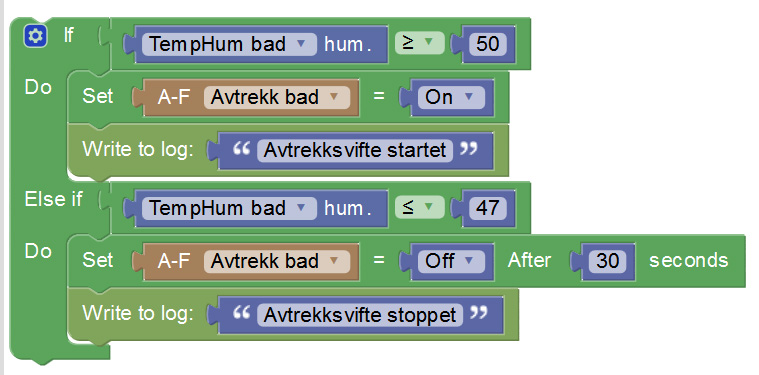

This is a blocky I used, worked fine....
Try to remove the level bit..
One quick tip ...click on "Show current states" here you can see the pure value on the sensor you want to use ...

thanks for the info. I removed the level logic, but still nothing happens. Manually, it works. However, when i click 'show current states', it shows temperature and humidity as values. Might that be the problem ? That the values are not equal ?

Apparantly I was too impatient. After removing the level logic like you said, the fan automatically was switched on after a while. So it works now.
But, the fan is not very strong and it took hours to get from 65% to 60%. So I guess I need a better fan.
Anyway, the blocky script works
