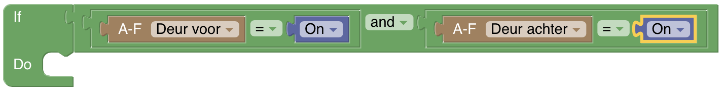

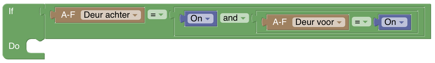

I made some quick screenshots to explain. This is not the actual logic, but the same principal.
Your blocky and/or looks like: which means: if thingA = ( on or (thingB = on))
But should look like: which means: if (thingA = on) or (thingB = on)
