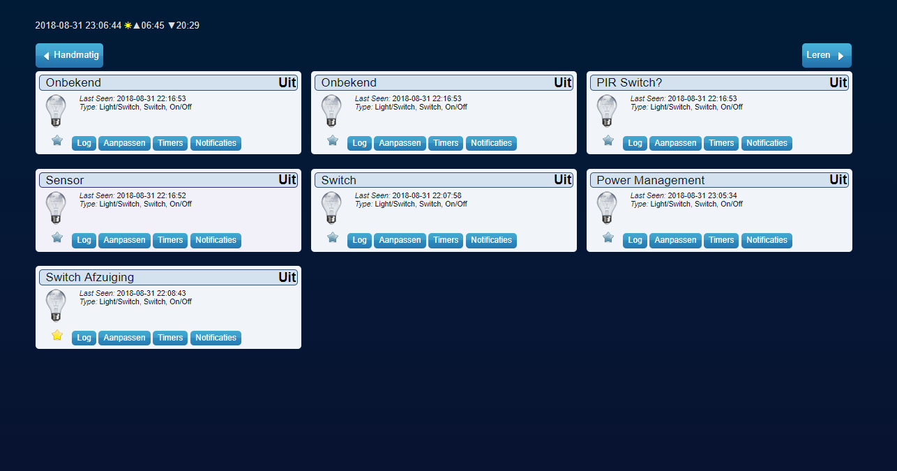

I have installed the multisensor 6, nano switch and the plug. I get temperature readings from the various sensors and when the motion alarm is tripped two switches switch to on. I can turn the lights on through the switch interface in Domoticz, the same goes for the extractor fan connected through the wall plug. Great! The situation is as below;

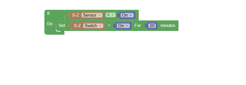

The switches named "Sensor" and "Pir switch?" switch on when motion is detected. To controll the lights I made the following script in blockly after watching a few tutorial on youtube;
I've activated it but when the multisensor detects motion ..... nothing happens. I have tried both sensors that I believe are associated with the multisensor. I have tried turning the wall plug on with this script ... nothing happens. I have no idea what I am doing wrong?

You should be good. Perhaps you need to check the PIR switch.
Wave in front of your multi sensor and check which switch switches on. That is the one to check. In the configuration of Z-Wave you can also check which devices are connected to the multi sensor.
