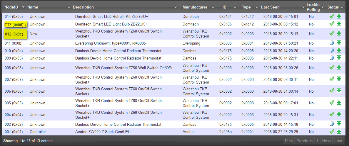

I am just starting to play with Dashticz and am having some issues when creating my first config file Dashticz is not showing some of my devices which are in Domoticz? The devices that are missing are replicas of other devices which do show up in Dashticz? Does this make sense?
I have attached the devices screen from Domoticz and I am using the default config file with only the IP and PORT modified so it should be pulling in all devices?
Any help would be greatly appreciated as I love what the developers have done with this project, many thanks.

Did you mark them as favorite?
