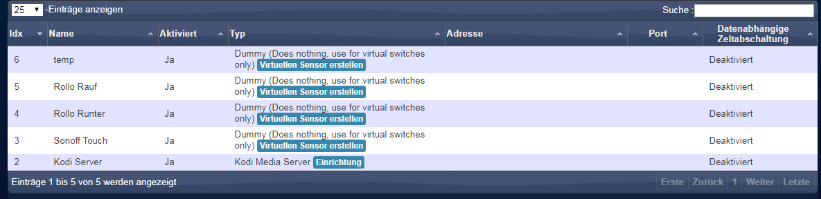

I have a big Problem.
When I turn on my Living room Lamp on, the shutter motor turn on too.
Lamp switch is a sonoff touch. I turn it on with dummy device and http command.
The Shutter motor the same.
Both have espeasy.
2018-08-26 22:27:05.281 Status: User: Cino initiated a switch command (2/Lampe 1/On)
2018-08-26 22:27:05.664 Status: User: Cino initiated a switch command (3/Rollo runter/On)
2018-08-26 22:27:15.956 Status: User: Cino initiated a switch command (3/Rollo runter/Off)
The switches are Lampe 1 and Rollo runter

Check your espeasy rules - looks like you may have used the same Domoticz idx for both devices.

MikeF wrote: Tuesday 28 August 2018 8:35 Check your espeasy rules - looks like you may have used the same Domoticz idx for both devices.
+1
