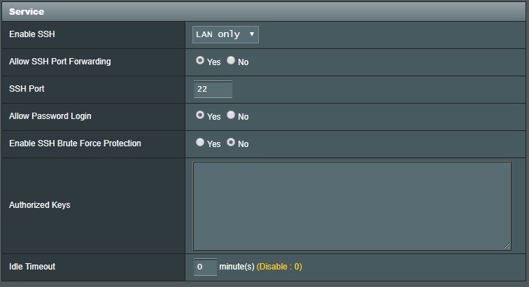

After reading the posts, I hoped this would work with my router (Asus RT-AC51U), so I tried the steps on this, and I think I've everything working on both router and domoticz site (choose option 1 for SSH).
But after restarting and enabling the hardware i got this:

My wifes phone got some problems on connecting to the router yesterday. She started to get wrong password when shes connecting to the wifi.
So I updated the firmware to the latest Asuswrt-Merlin 384.6, and its working good for her phone now.
But after that the script stopped working.
Its givng me the following error :
Error: (Presence detection WIFI) No usable commandline to check presence. Trying again to detect router capabilities.
Error: (Presence detection WIFI) Temporarily limiting the polling frequency after encountering 5 (ssh) errors in a row.
Error: (Presence detection WIFI) SSH subprocess failed with error (255):b''
Error: (Presence detection WIFI) Could not determine router capabilities
Here are the ssh configuration on the router.
What do I need to change ??
//Magnus Svensson
Melotron
Posts: 62
Joined: Tuesday 22 November 2016 21:04
Location: Gothenburg
Re: Python plugin: Presence detection from wireless router
Post by Melotron »
Solved it.
Figured out at work that I needed to delete the old ssh key and get a new one.
sudo ssh-keygen -f "/root/.ssh/known_hosts" -R 192.168.1.1

@Melotron:
Glad you got it working again and thanks for the tip to others! If the ssh key on either side changes it will indeed also break ssh key based login.
I don't recall asuswrt-merlin generating a new key after my last update, but that will likely differ between versions and upgrade methods. Hopefully it won't be necessary every time. Maybe you can backup and restore the keys when updating(?)
