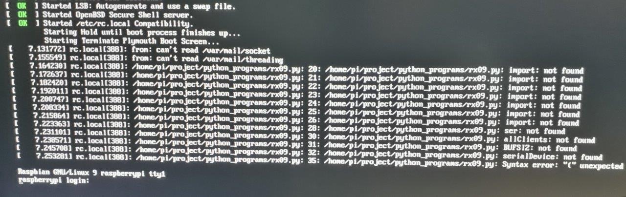

In the old devices.csv I only had your values. I did not learn my own remote controls there because I did not know exactly how it works.
Now I have only one problem after the Pi started in the terminal with the RX09.py I have created and attached a screenshot.
Maybe you have a solution for me.
Vilelen thanks in advance
RaspberryPI Home Assistant with -> AppleHome, HUE, Osram, Ikea, Aqara, Xiaomi, Worx, SmartLife, AlphaESS, Meross, Viessmann, PhillipsTV, Shelly
RaspberryPI3 Domoticz -> EldatEasywave, Wunderground, MagicLight
WimR
Posts: 46
Joined: Saturday 03 February 2018 17:18
Location: Belgium
Re: Eldat Easywave RXR09 Script
Post by WimR »
Hi Aeisenhuth,
at first look it seems python isn't able to read the needed libraries -> "import" is failing.
Could you check if python has been correctly installed on your new Pi?
You'll need python 3.5.1
Also please check the line in rc.local launching the rx09.py. Does it start with "python /usr/pi/……"?
the devices.csv has a simple structure:
The Easywave transmitter identification: 2ead4f
followed by ;
and the idx it has to be attached to.
The Easywave transmitter identification will show up in the Log file whenever a transmitter is used.
If the identification isn't yet in the devices.csv it will be logged as "'Warning : unknown physical RF transmitter...."
You can than "see" what the identification of your transmitter/remote button is.
regards
Wim
