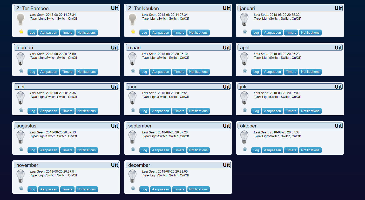

Derik
Posts: 1605
Re: Help Example, months of the year
Post by Derik »
Dear all.
Thanks for this, i see now your reaction, i get no notification from the forum??
So i give it a try .... this evening
you hear from me..
Ps i can change the names for the months in the script to what i want?
En what setting do i need in dz vents.. all time or device?
Edit:
Error:
 2018-08-20 20:13:14.485 Status: dzVents: Error (2.4.7): error loading module 'DZ: Maanden' from file '/home/pi/domoticz/scripts/dzVents/generated_scripts/DZ: Maanden.lua':
2018-08-20 20:13:14.485 ...moticz/scripts/dzVents/generated_scripts/DZ: Maanden.lua:9: unexpected symbol near '`'
2018-08-20 20:13:14.544 Status: dzVents: Error (2.4.7): error loading module 'DZ: Maanden' from file '/home/pi/domoticz/scripts/dzVents/generated_scripts/DZ: Maanden.lua':
2018-08-20 20:13:14.544 ...moticz/scripts/dzVents/generated_scripts/DZ: Maanden.lua:9: unexpected symbol near '`'

Derik
Posts: 1605
Post by Derik »
mm i did try only 1 month
No thing in the log..
i make first all the months...
then
I be back :-)
Derik wrote: Monday 20 August 2018 20:35 mm i did try only 1 month
then
I be back :-)
And please load the example again. Found one other typo
Derik
Posts: 1605
Post by Derik »
Did all the months:
and:
No thing to see in the log
Derik wrote: Monday 20 August 2018 20:45 No thing to see in the log
Can you copy / paste the script again and report your findings ?
At least something should be visible in the logfile.

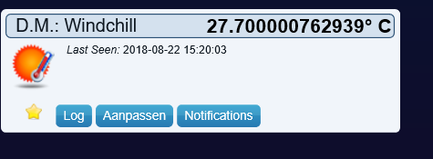

-- setWindChill.lua
    on      =   {   timer  =   { "every 10 minutes" }}, -- the script will run every 10 minutes
--   logging =   {   level       =   domoticz.LOG_DEBUG,   -- this sets the loglevel. Options are LOG_INFO, LOG_DEBUG, LOG_ERROR or LOG_FORCE
--                   marker      =  "setWindchill" },    -- the marker will ensure you can see where information comes from
    execute = function(dz)  -- the parm dz (short for domoticz) will ensure all information from domoticz is available in this script
        -----  enter your settings below this line -------------------------------------------------------------------------------
        myTemperature   = dz.devices("Buiten: Terras")          -- Name of your windDevice within quotes or idx without quotes
        myWind          = dz.devices("D.M.: Buienradar - Wind") -- Name of your temperatureDevice within quotes or idx without quotes
        myWindChill     = dz.devices("D.M.: Windchill")          -- Name of your windchill Device within quotes or idx without quotes
        -----  enter your settings above this line -------------------------------------------------------------------------------
        function windChill(windSpeed, temperature)
           if temperature ==   nil then return -99     -- Should not happen
           elseif windSpeed == nil then return -99     -- Should not happen
            -- chill temperature cannot be calculated for these conditions
           elseif windSpeed < 1.3 or windSpeed > 49 or temperature < -46 or temperature > 17 then return temperature
           return dz.utils.round(13.12 + (0.6215 * temperature) - (13.96 * math.pow(windSpeed, 0.16)) + (0.4867 * temperature * math.pow(windSpeed, 0.16)), 1)
        myWindChill.updateTemperature(windChill(myWind.speed,myTemperature.temperature))
The output:
Log:
 17:50:00.810 Status: EventSystem: Script event triggered: /home/pi/domoticz/dzVents/runtime/dzVents.lua
2018-08-22 17:50:05.897 Status: EventSystem: Script event triggered: /home/pi/domoticz/dzVents/runtime/dzVents.lua
2018-08-22 17:50:11.600 Status: EventSystem: Script event triggered: /home/pi/domoticz/dzVents/runtime/dzVents.lua
2018-08-22 17:50:20.599 Status: EventSystem: Script event triggered: /home/pi/domoticz/dzVents/runtime/dzVents.lua
2018-08-22 17:50:30.325 Status: EventSystem: Script event triggered: /home/pi/domoticz/dzVents/runtime/dzVents.lua
2018-08-22 17:50:38.978 Status: EventSystem: Script event triggered: /home/pi/domoticz/dzVents/runtime/dzVents.lua
2018-08-22 17:50:47.763 Status: EventSystem: Script event triggered: /home/pi/domoticz/dzVents/runtime/dzVents.lua
That are scripts without any thing?
Perhaps one of these?
