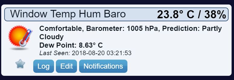

EddyG thanks for putting together the flow for the Xiaomi Temp + Hum + Baro sensor (saved me a lot of time!)
I've modified it slightly for a sensor that I just installed (also Xiaomi) but it's for Temp + Hum + Baro in a single sensor.
Also corrected a error RE the battery status, the word battery needs to start with a capital B
Also note for those searching since I did not find a posted solution:
Above is how to input Temperature Humidity and Barometer (Temp Hum Baro) into Domoticz via MQTT (working).
[{"id":"ccd928ae.df6e08","type":"mqtt in","z":"f962b96d.7044c8","name":"zigbee2mqtt/out","topic":"zigbee2mqtt/bedroomwindowtempsensor","qos":"2","broker":"6e165f21.f7645","x":340,"y":340,"wires":[["30c7887d.0db668"]]},{"id":"30c7887d.0db668","type":"json","z":"f962b96d.7044c8","name":"","property":"payload","action":"","pretty":false,"x":490,"y":340,"wires":[["903fbd0c.967e8"]]},{"id":"37f9ac4c.00d154","type":"mqtt out","z":"f962b96d.7044c8","name":"","topic":"domoticz/in","qos":"","retain":"","broker":"cd51966f.aa7e38","x":790,"y":340,"wires":[]},{"id":"903fbd0c.967e8","type":"function","z":"f962b96d.7044c8","name":"Format Data","func":"var temp = msg.payload.temperature;\nvar humi = msg.payload.humidity;\nvar pres = msg.payload.pressure;\nvar batt = msg.payload.battery;\nvar rssi = msg.payload.linkquality;\n\nmsg.payload = {}\n\n// Humidity Status\nif (humi < 31) {\n humistat = \"2\";\n} else if (humi > 69) {\n humistat = \"3\";\n} else if (humi > 34 && humi < 66 && temp > 21 && temp < 27) {\n humistat = \"1\";\n} else {\n humistat = \"0\";\n}\n\n// Pressure Status\nif (pres < 966) {\n forecast = \"4\";\n} else if (pres < 993) {\n forecast = \"3\";\n} else if (pres < 1007) {\n forecast = \"2\";\n} else if (pres < 1013) {\n forecast = \"3\";\n} else if (pres < 1033) {\n forecast = \"0\";\n} else {\n forecast = \"1\";\n}\n\nmsg.payload.idx = 1221\nmsg.payload.nvalue = 0\nmsg.payload.svalue = temp.toString()+\";\"+humi.toString()+\";\"+humistat+\";\"+pres.toString()+\";\"+forecast;\nif (typeof batt !== 'undefined' && batt !== null){\nmsg.payload.Battery = Math.round(batt);\n}\nif (typeof rssi !== 'undefined' && rssi !== null){\nrssi = Math.round(rssi / 12);\nif (rssi > 12) {\n rssi = 12;\n}\nmsg.payload.RSSI = rssi;\n}\nreturn msg;","outputs":1,"noerr":0,"x":630,"y":340,"wires":[["37f9ac4c.00d154"]]},{"id":"6e165f21.f7645","type":"mqtt-broker","z":"","name":"Zigbee","broker":"localhost","port":"1883","clientid":"","usetls":false,"compatmode":true,"keepalive":"60","cleansession":true,"birthTopic":"domoticz/bridge/state","birthQos":"0","birthPayload":"online","closeTopic":"","closeQos":"0","closePayload":"","willTopic":"","willQos":"0","willPayload":""},{"id":"cd51966f.aa7e38","type":"mqtt-broker","z":"","name":"Domoticz","broker":"192.168.0.5","port":"1883","clientid":"","usetls":false,"compatmode":true,"keepalive":"60","cleansession":true,"birthTopic":"","birthQos":"0","birthPayload":"","closeTopic":"","closeQos":"0","closePayload":"","willTopic":"","willQos":"0","willPayload":""}]

Re: Zigbee2MQTT
Yes, I also found out about the capital B.ben53252642 wrote: Sunday 19 August 2018 19:23 Also corrected a error RE the battery status, the word battery needs to start with a capital B
What you also can do is: replace all the 'delete msg.payload.xxx' with one single 'msg.payload = {};'
I am also now on version: zigbee2mqtt version 0.1.3 and that version also has linkquality, which could be used as RSSI which ranges from 0 to 12.
B.t.w. that works too...
Currently I use the code, mind the capitals again: RSSI
if (rssi > 12) {
rssi = 12;
msg.payload.RSSI = rssi;-
