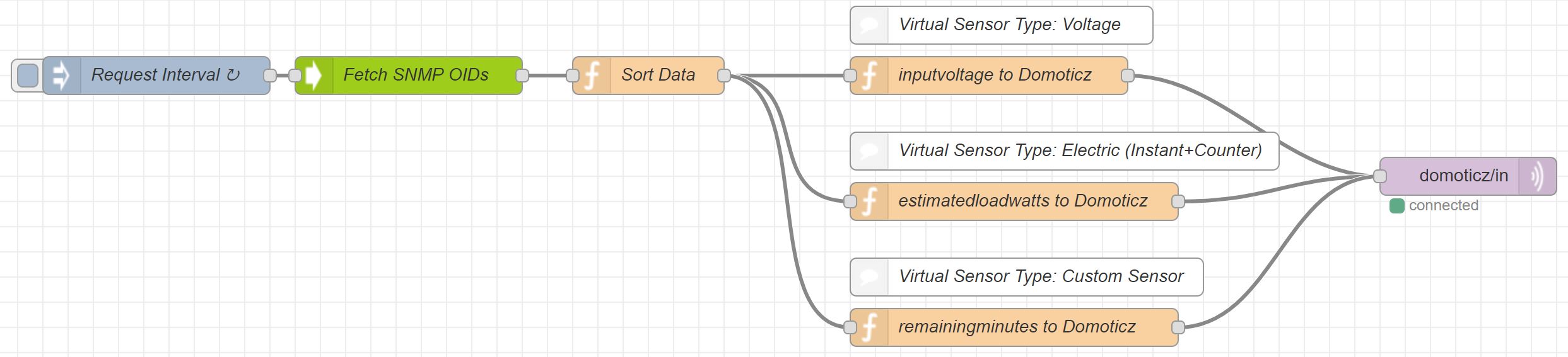

You should also be able to use only a Single Domoticz MQTT, not sure if you can use only a single source MQTT as I have yet to receive my Zigbee adapters but in my UPS Flow I've got 3 functions sending to a single MQTT at the same time non-stop for about 12 hours without problems.
Structure the functions like this so the idx, svalue and nvalue etc... don't get sent to the MQTT unless more than 1
// inputvoltage
msg.payload = {};
msg.payload.inputvoltage = global.get('msg.payload.inputvoltage');
if (msg.payload.inputvoltage > 1) {
msg.payload.idx = 1128 ;
msg.payload.nvalue = 0 ;
msg.payload.svalue = msg.payload.inputvoltage;0;
return msg;

So you think that in 1 MQTT message there can be 2 Domoticz devices (idx)? How?
ben53252642
Posts: 543
Re: Zigbee2MQTT
Post by ben53252642 »

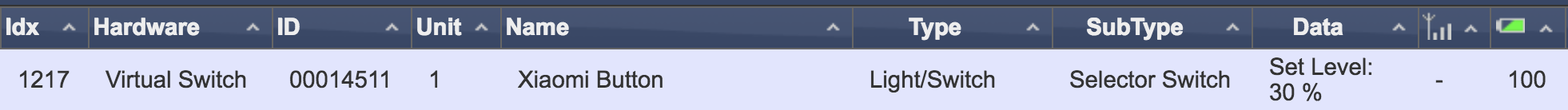

Xiaomi Button Model: WXKG01LM
Functions:
* Click
* Double Click
* Triple Click
* Quadruple Click
* Many Click
* Long Click (Hold for about 1.5 seconds)
* Long Click Button Release
Create selector switch in Domoticz with levels (in order):
click 10
double 20
triple 30
quadruple 40
many 50
long 60
long_release 70
Suggest setting the "Selector Style" of the switch to "Select Menu".
Enter the Zigbee ID into the "Xiaomi Button" MQTT then enter the IDX into the Node Red "Format Data" function

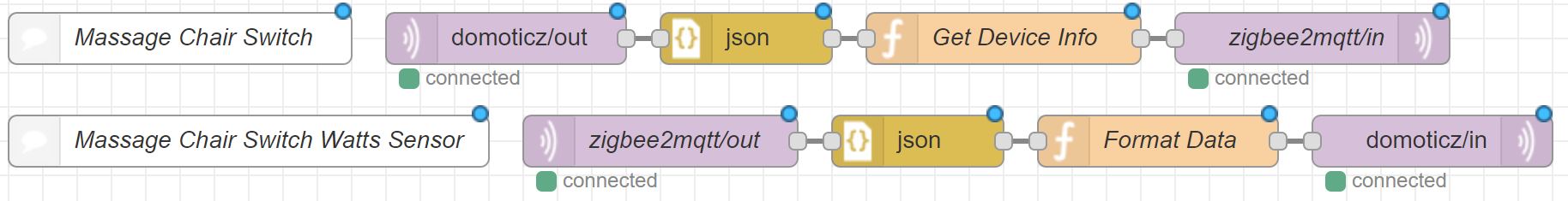

Xiaomi Mi power plug ZigBee (on/off, power measurement) Model: ZNCZ02LM
https://github.com/Koenkk/zigbee2mqtt/w ... ed-devices
Control power plug on / off from Domoticz
Received power usage in Domoticz sensor
[{"id":"bfb978ea.1c29a8","type":"mqtt in","z":"f962b96d.7044c8","name":"","topic":"domoticz/out","qos":"2","broker":"cd51966f.aa7e38","x":310,"y":140,"wires":[["6e3cd26.8d72b2c"]]},{"id":"c8d4fb13.30ca38","type":"function","z":"f962b96d.7044c8","name":"Format Data","func":"// Virtual Sensor Type: Electric (Instant+Counter)\n// Must choose type \"Computed\" or it will not work\nvar power = msg.payload.power.toString();\nmsg.payload.idx = 1215 ;\nmsg.payload.nvalue = 0 ;\nmsg.payload.svalue = power;0;\nreturn msg;\n","outputs":1,"noerr":0,"x":690,"y":200,"wires":[["80442fa5.5053e"]]},{"id":"6d2eec89.b606f4","type":"function","z":"f962b96d.7044c8","name":"Get Device Info","func":"if(msg.payload.idx == '1214') {\nif(msg.payload.nvalue == '0') {\n    msg.payload.state = 'OFF'\n}\nif(msg.payload.nvalue == '1') {\n    msg.payload.state = 'ON'\n}\nreturn msg;\n}","outputs":1,"noerr":0,"x":600,"y":140,"wires":[["3fb0ea7f.fc1cd6"]]},{"id":"6e3cd26.8d72b2c","type":"json","z":"f962b96d.7044c8","name":"","property":"payload","action":"","pretty":false,"x":450,"y":140,"wires":[["6d2eec89.b606f4"]]},{"id":"3fb0ea7f.fc1cd6","type":"mqtt out","z":"f962b96d.7044c8","name":"zigbee2mqtt/in","topic":"zigbee2mqtt/massagechair/set","qos":"","retain":"","broker":"cd51966f.aa7e38","x":780,"y":140,"wires":[]},{"id":"a72f1084.5c017","type":"comment","z":"f962b96d.7044c8","name":"Massage Chair Switch","info":"","x":120,"y":140,"wires":[]},{"id":"403248de.8336e8","type":"mqtt in","z":"f962b96d.7044c8","name":"zigbee2mqtt/out","topic":"zigbee2mqtt/massagechair","qos":"2","broker":"6e165f21.f7645","x":400,"y":200,"wires":[["e36288fb.8e9178"]]},{"id":"2c40ce27.36da12","type":"comment","z":"f962b96d.7044c8","name":"Massage Chair Switch Watts Sensor","info":"","x":160,"y":200,"wires":[]},{"id":"e36288fb.8e9178","type":"json","z":"f962b96d.7044c8","name":"","property":"payload","action":"","pretty":false,"x":550,"y":200,"wires":[["c8d4fb13.30ca38"]]},{"id":"80442fa5.5053e","type":"mqtt out","z":"f962b96d.7044c8","name":"","topic":"domoticz/in","qos":"","retain":"","broker":"cd51966f.aa7e38","x":850,"y":200,"wires":[]},{"id":"cd51966f.aa7e38","type":"mqtt-broker","z":"","name":"Domoticz","broker":"192.168.0.5","port":"1883","clientid":"","usetls":false,"compatmode":true,"keepalive":"60","cleansession":true,"birthTopic":"","birthQos":"0","birthPayload":"","closeTopic":"","closeQos":"0","closePayload":"","willTopic":"","willQos":"0","willPayload":""},{"id":"6e165f21.f7645","type":"mqtt-broker","z":"","name":"Zigbee","broker":"localhost","port":"1883","clientid":"","usetls":false,"compatmode":true,"keepalive":"60","cleansession":true,"birthTopic":"domoticz/bridge/state","birthQos":"0","birthPayload":"online","closeTopic":"","closeQos":"0","closePayload":"","willTopic":"","willQos":"0","willPayload":""}]
