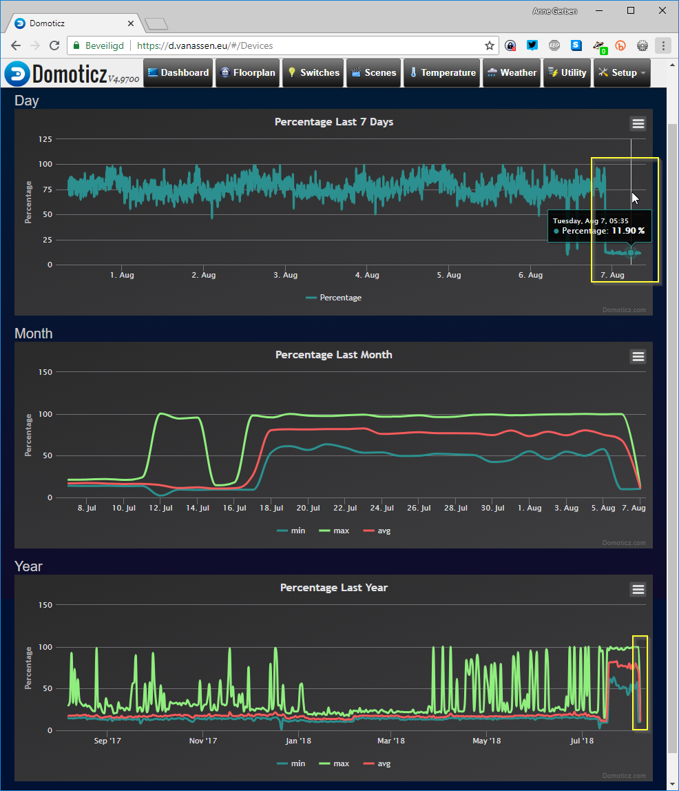

I'm running 4.9700 (stable) on rpi2 but when I have dzvents enabled if have high cpu load.
It's adding about 50% cpu load to the averige, when I disable dzvents the cpu usage drops immediately.
I've added a screen shot where you can see in the yellow square when I've enabled dzvents and temp disabled it.
I'm running 3 simple scripts which when I open a door a turn on the lights or send me a message.
I like dzvents, but the cpu usage is to high it's slowing down my system.
anyone an idea how to fix this issue?
2018-08-06 13_55_57-Domoticz.png (219.7 KiB) Viewed 2978 times

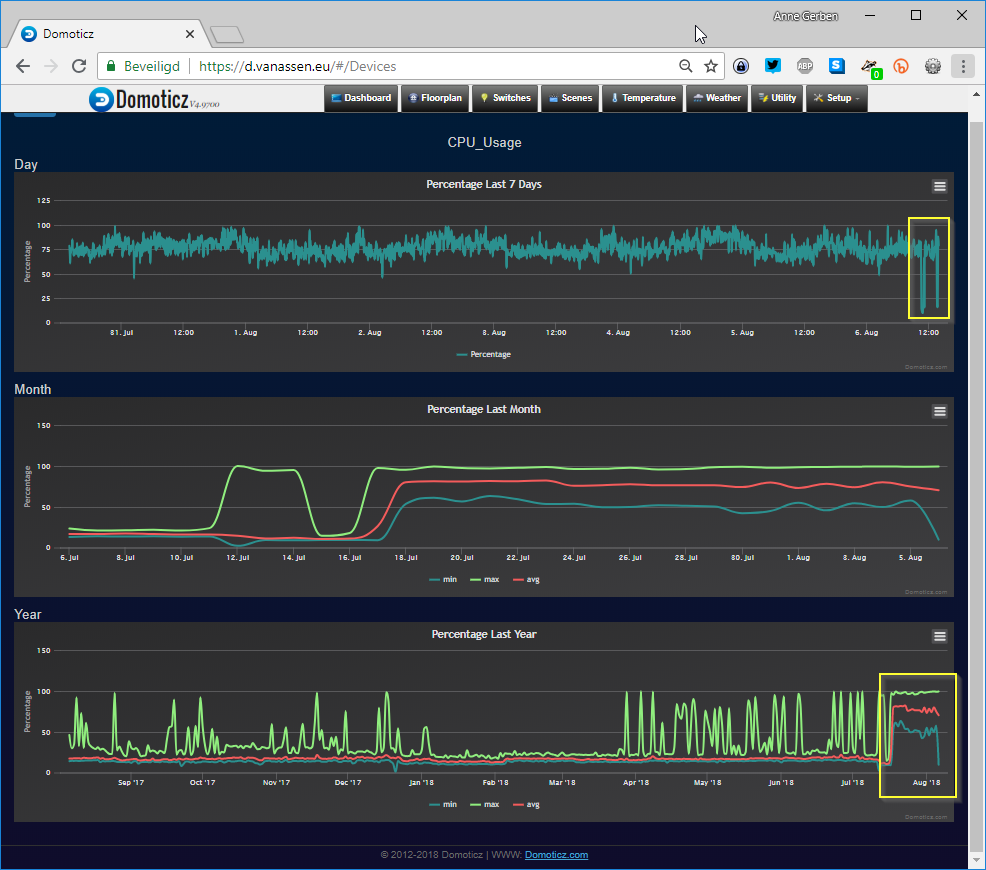

logging is set to "error + minimal execution"
I had three script running and have disabled them now.
cpu usage is now back to +- 12%, I'll add a screenshot tomorrow.

todays graph
2018-08-07 08_14_58-Domoticz.png (278.95 KiB) Viewed 2926 times

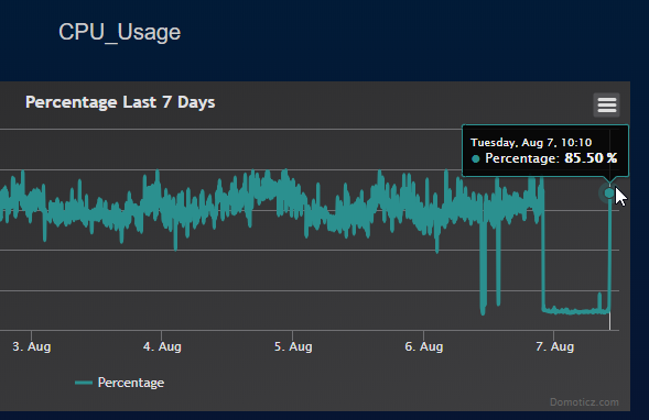

when I enable on of the scripts cpu load directly high again.
I've updated one of the scripts to report on a dummy switch, but no errors in the logs:
2018-08-07 10:09:01.993 Status: EventSystem: Script event triggered: SolarInverter
2018-08-07 10:09:39.045 Status: User: AG initiated a switch command (563/TAG-Bezoek/On)
2018-08-07 10:09:40.051 Status: dzVents: Info: Handling events for: "TAG-Bezoek", value: "On"
2018-08-07 10:09:40.052 Status: dzVents: Info: ------ Start internal script: deurgeopend: Device: "TAG-Bezoek (TAG)", Index: 563
2018-08-07 10:09:40.052 Status: dzVents: Info: ------ Finished deurgeopend
2018-08-07 10:09:40.673 Status: EventSystem: Script event triggered: /home/pi/domoticz/dzVents/runtime/dzVents.lua
2018-08-07 10:09:40.703 Status: Notification: TAG-Bezoek On
2018-08-07 10:10:12.677 Status: EventSystem: Script event triggered: SolarInverter
2018-08-07 10_12_42-Window.png (53.55 KiB) Viewed 2908 times
