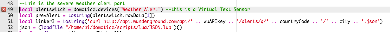

The attachment Screen Shot 2018-07-26 at 17.37.14.png is no longer available
Getting this error in the events-box
Screen Shot 2018-07-26 at 17.37.14.png (51.64 KiB) Viewed 2433 times
elmortero
Posts: 248
Joined: Sunday 29 November 2015 20:46
Domoticz version: 3.9639
Location: Spain
Re: Rain prediction - weather underground
Post by elmortero »
EdwinK, maybe also post the log where it tells more about the error.
Or tell what the balloon says when you move the mouse over the red cross.
EdwinK
Posts: 1820
Location: Rhoon
Post by EdwinK »
O.. I thought I had done that.
The error is: expected ']' near 'local'
(it's in the severe weather part of the script).
Because of the error I removed that part for now.
