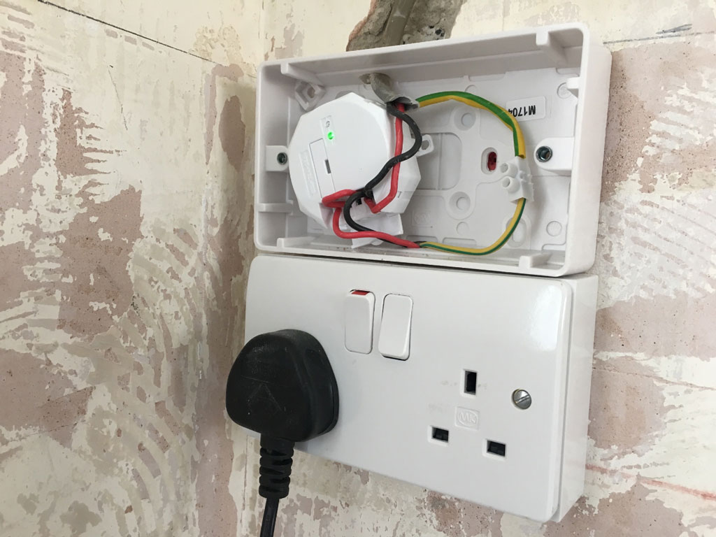

Re: LightwaveRF Relay not behaving as expected in Domoticz
Found the photo of when I installed the relay. I'm pretty sure it's wired up correctly as the manual explains to switch a mains power supply on or off.
Behaviour is still the same by the way. When the relay is turned 'Off' in the LW app, it cuts out and won't turn back on unless I cycle the power to the relay.
However, when sending 'Open and Stop' commands, the sockets are turned on and off.
- LW821.jpg (122.8 KiB) Viewed 1151 times
This is no help I know but I use a few of these and have them all as On/Off in Domoticz and they work fine.
One is used as to switch between 2 circuits, another is switching zero volts, the others are wired in the same way as your image shows.
