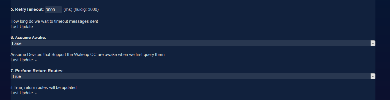

There is a new setting in the Zwave usb controller perhaps play with that

5 6 and 7 u can play with this perhaps something make a different s..

Turns out I don't have these options (or I am looking in the wrong place..
