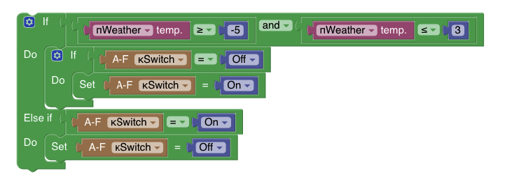

I've got a Blocky script (trigger=Device) for a switch, dependent on temperature.
When script is on, I'm unable to voluntary turn the switch On from physical button or Domoticz, cause Blocky instantly sends an Off MQTT-command (temperature conditions aren't met).
I expect a script to fire up only on Temperature change (a device in starting Control block).
With an hour-long telePeriod (weather update period) a manual override should work for 1-60 min.
Seems, switch is exclusively possessed by Blocky now.
How a voluntary override can be implemented? Inside a script only?
I'm thinking of a separate virtual Switch like "Script enabled" or "Manual override", which could be a condition for this script.
freijn
Posts: 536
Domoticz version: Stable
Re: Blocky overrides manual switch toggle
Post by freijn »
An aditional virtual swich is indeed the way to go.
