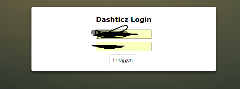

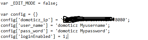

What i post, i try it by myself. Its working here.Dave47 wrote: Wednesday 25 July 2018 13:33this does not workCode: Select all
config['user_name'] = 'domoticz Myusername'; config['pass_word'] = 'domoticz Mypassword'; config['loginEnabled'] = 1;Try to clear cache and remove cookies in your browser
Look @ attchments.
- dash2.png (6.73 KiB) Viewed 4162 times
- dash.png (35.14 KiB) Viewed 4162 times
