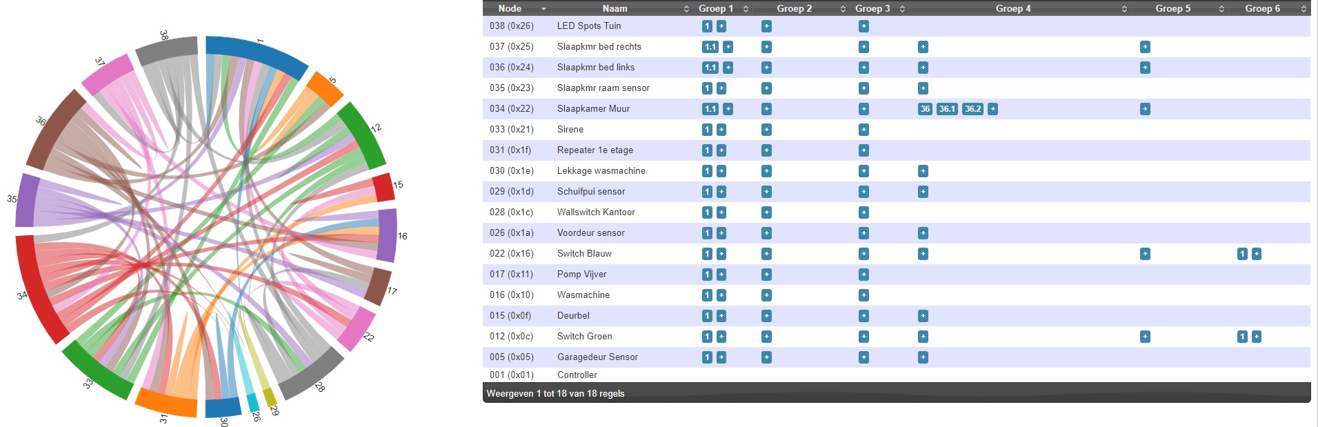

I have three Fibaro FGS-223 double swithces in my bedroom. If I press the second switch on the wall (Node:034) I want the first Switch of Node 036 to also switch on.
In the Fibaro manual I see that Group 4 is the group connected to the second switch. My conclusion was that I should add 36 to Group 4 of Node 034 but this does not seem to work.
See my network and group diagram below. I also added 36.1 and 36.2 to Group 4 just to see if that would work but sofar no luck.
What am I doing wrong?

- Network.jpg (277.25 KiB) Viewed 946 times
