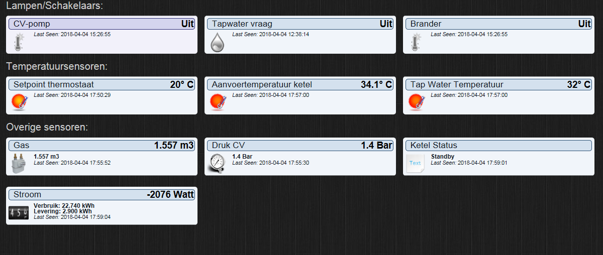

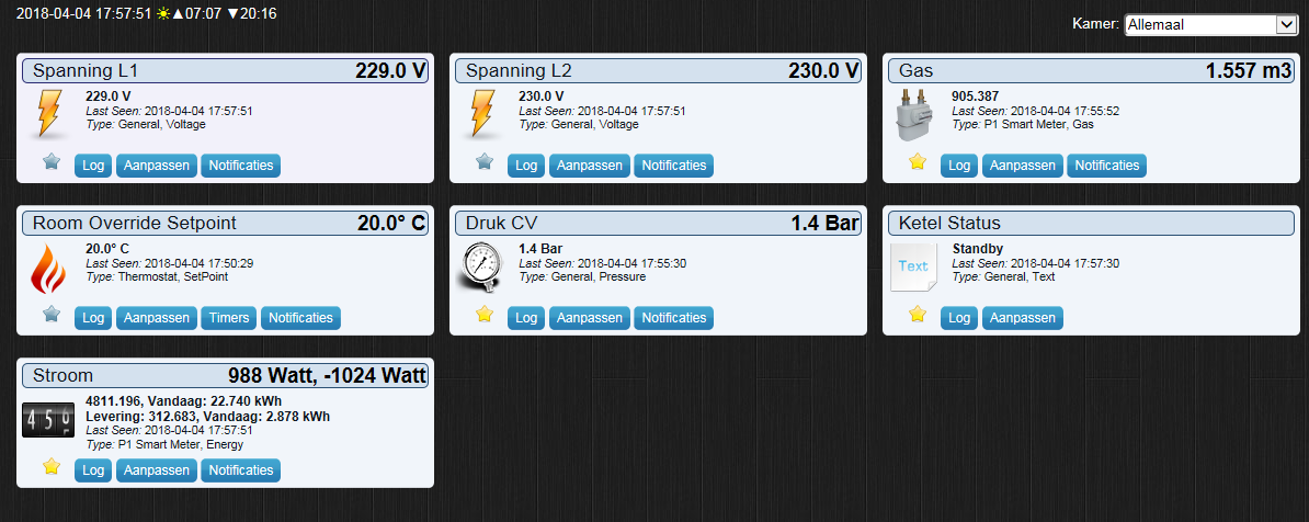

I have a Raspberry PI 3B with Domoticz and a Smart meter P1 to USB cable.
This works fine, but since I have a 3-fase installation, it's possible to consume power from the supply and at the same time deliver back.
At the sensor screen this is shown as it should be but the total calculation on the Dashboard screen is not correct.
I also installed the Domoticz app on my Android Phone, and then the valua is correct :?:
Is it possible to adjust this for the Windows webbrowser?
Another question on this: I want to make a floorplan, and I was trying something; but when I put the power there the day total is shown and I want the current value.
It's kind of a long story, but maybe the answer is quite simple, but I couldn't find it on the forum and the wiki :oops:
