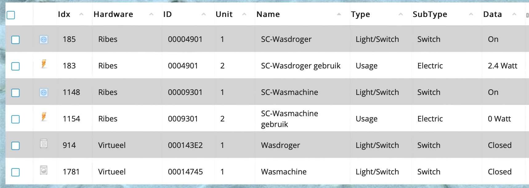

Schermafbeelding 2020-12-06 om 15.29.58.png (249.47 KiB) Viewed 4012 times

Are the SC-devices "Real" deviced and the not-SC devices dummy's in your screenshot?

Post by felix63 »
The SC devices are real.

felix63 wrote: Monday 09 July 2018 11:14 The SC devices are real.
And the "Wasdroger" device? Is that a real device too or a dummy?
Bit hard to see the difference between "SC-Wasdroger" and "Wasdroger" for me.
felix63
Posts: 244
Domoticz version: 2020.1
Location: Gouda
Re: Is the washing machine done?
Post by felix63 »
The SC-Wasdroger verbruik shows the current power usage. The SC-Wasdroger is the socket the dryer is physically plugged in to. The Wasdroger device is a logical device showing the assumed state of the dryer (on/off) based on power consumption on the socket. Does this help?
terrorsource
Posts: 67
Joined: Wednesday 10 May 2017 17:57
Post by terrorsource »
felix63 wrote: Thursday 12 July 2018 11:21 The SC-Wasdroger verbruik shows the current power usage. The SC-Wasdroger is the socket the dryer is physically plugged in to. The Wasdroger device is a logical device showing the assumed state of the dryer (on/off) based on power consumption on the socket. Does this help?
I guess.
My case:
PowerPlug Switch : Droger = your SC-Wasdroger
PowerPlug power usage: Droger_Unknown4 = your SC-Wasdroger verbruik
Dummy: DrogerDummy = your Wasdroger
