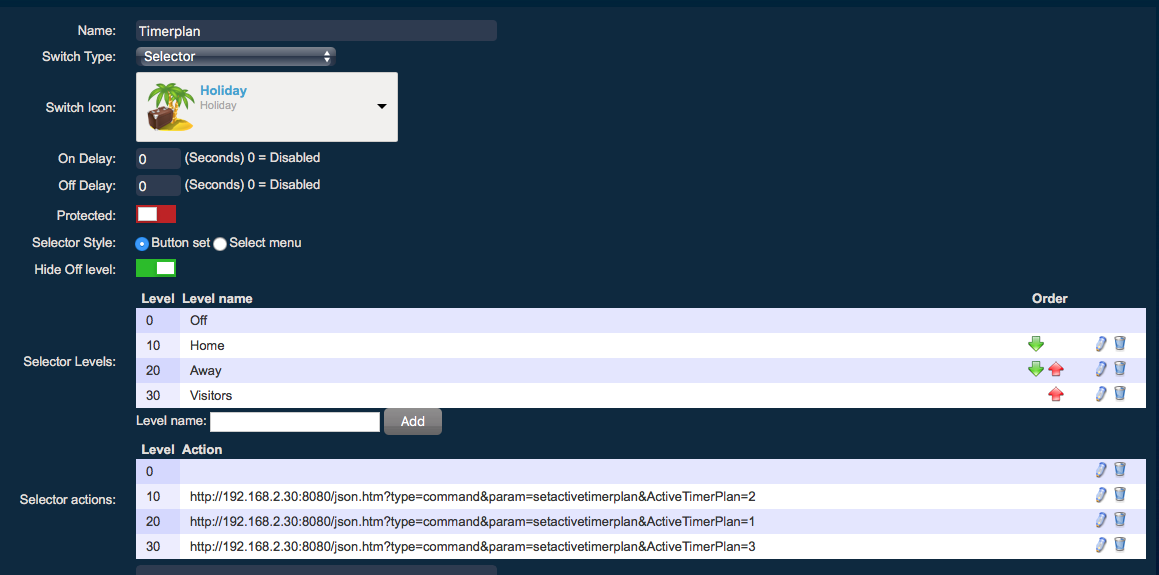

In Domoticz you can create a number of different timerplans (setup>plans>timerplan).
In my case 3 (Home, Away, Visitors):
In order to select the correct timperplan, I use a selector switch (switches>manual light/switch>Hardware.Virual>Switch type.Selector), with the following detail.

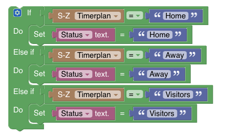

You want to know which timerplan is in use. On the dashboard, in my case the main floor plan, you cannot see the status of the selector switch. For this I used a text device and named it Status. (setup>hardware>create virtual sensors>text)
This text device get's its input from a "blocky" (Setup>more options>evens)
Now place the devices on the floorpan and you are done
