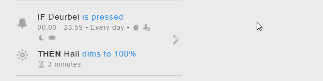

I have a task in my Homewizard and that's working fine see attachment.
Now I want to create the same with blocky so I can control it via Domiticz with only one change that the hallway must go on witf a delay of 10 sec
Can't see what i'm doing wrong . who can point me in the right direction.
Doorbell ---> Hallway
- doorbell-homewizard.png (9.66 KiB) Viewed 1068 times
- blocky doorbell.png (15.15 KiB) Viewed 1068 times
