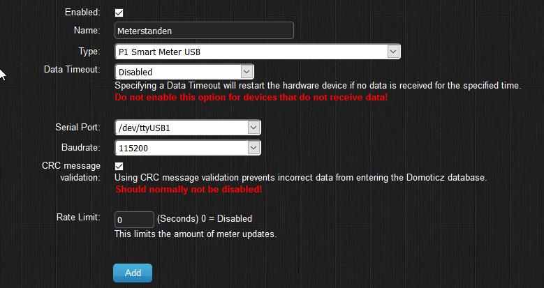

i bought a P1 usb kabel i have pluged it in my Raspberry and i see in Domoticz 2018-06-22 11:42:04.710 P1 Smart Meter: Using serial port: /dev/ttyUSB1
So far so good. in the hardware section i have enabled the "P1 Smart Meter USB" on USB1 but then ?... i dont see anything ?.
I would expect to see some new device in my devices section but nothing . what i'am doing wrong .

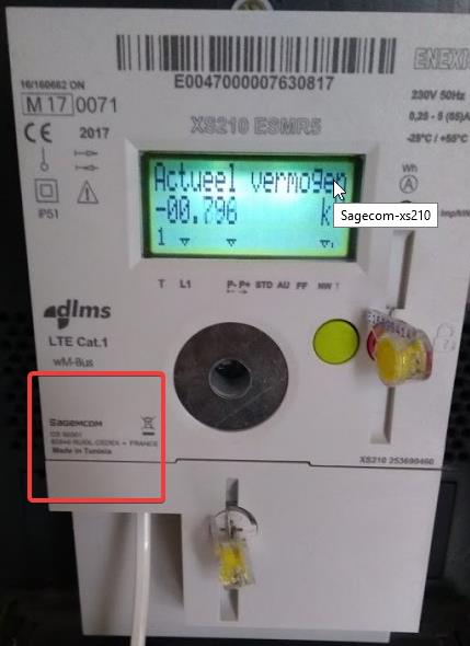

- smartmeter is from "Enexis" about 3 months ago is this one placed here

settings Domoticz smart meter / slimme meter

Anyway, I think the meter is not recognised by Domoticz.
Could be OR the wrong usb port (already tried the other one?)
OR you didn't limit the rate.
You have a ersm meter, that might have longer telegraphs then your pi can handle.
Try with limit 10? (10 seconds per message)

A cable is a cable... not true.
As I understood, the data from the Sagem has to be inverted. That is done with hardware (resistors) within the FTDI connector.
Als0, I read about bad cables (specially the RJ connector). They suffer with bad connections between the cable and contact points. That was the cause of troubles.
