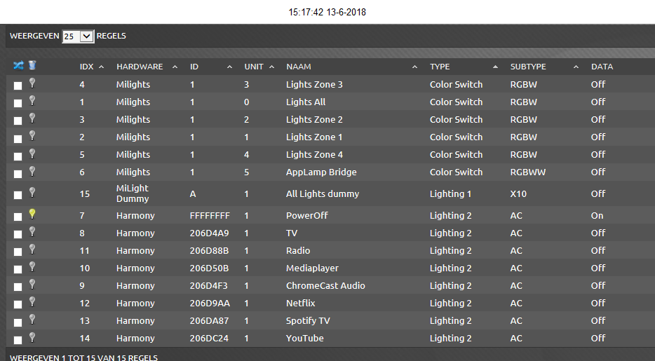

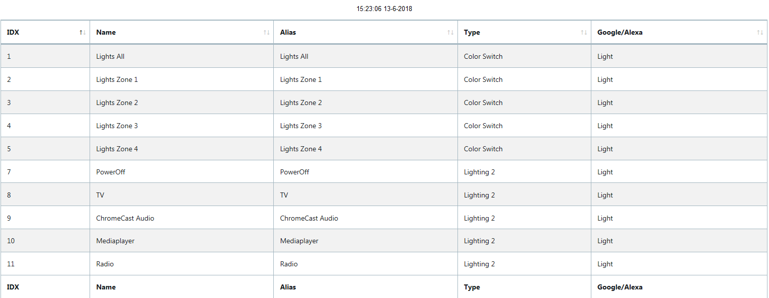

jpvaneijk wrote: Sunday 10 June 2018 15:14 Hi Guys,
In my floorplan I've got 2 rooms. 1 plan for Lights (Milights) and one plan for my mediacentre (Harmony Hub).
Before I had the Harmony Hub in a room, it wasn't showing in Controlicz. In GH I said 'turn all lights on' en GH responded: 'Turning 5 lights on'
Now the Harmony hub is in a room and all activity's are showing in Controlicz. When I say: 'Turn all lights of' GH responce is 'Turning 13 lights off'. Thats including TV. Sometimes the TV sets to another activity.
I Controlicz the Type for the lights is Color Switch and for the Hub's activity's it's Lighting 2.
In the Google/Alexa column however they are all 'Light'.
Is that the problem? How do I fix this?
Thanx!

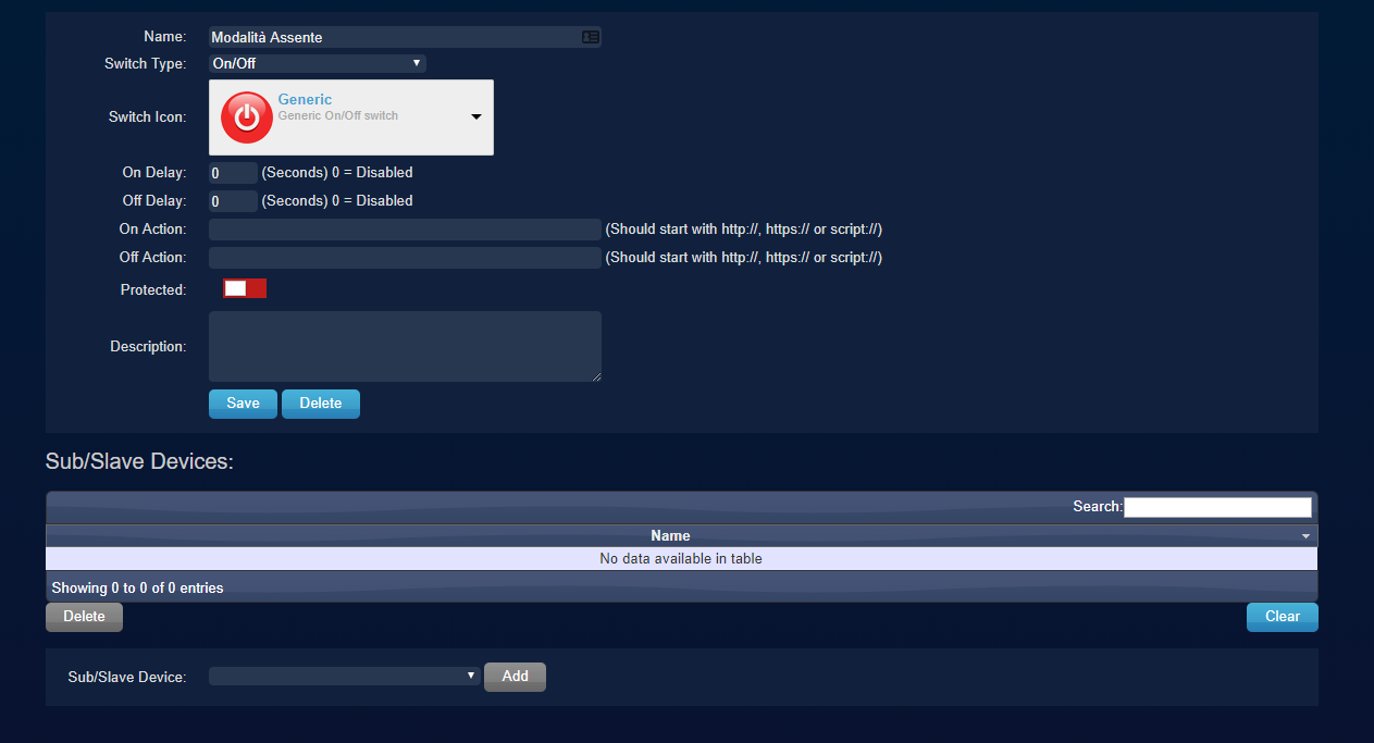

Re: to turn those things discovered as ‘Lights’ to switches - can you change the image in the device in domoticz to the ‘Generic’ image and check your profile again?

Madgeni wrote: Sunday 10 June 2018 18:40 Re: to turn those things discovered as ‘Lights’ to switches - can you change the image in the device in domoticz to the ‘Generic’ image and check your profile again?
You did it! Again :lol:
It worked: by changing the device in Domoticz (and issuing the sync command to GA) now Google can correctly identify those switches and also respond about their state.

In the Switchestab I can choose a different icon for a device. But I can't save it?
In the Switchestab I've got two rooms. Only the activity's of the Harmony hub (room = MediaCentre) are visible. The room for the Milghts (Livingroom) is empty? For sure that the Light-activity's are in that room...
When I go to the Switchestab it starts as 'Room: All', but it's empty?
Am I missing something over here?

In Domoticz, you can change the icon for the device

Change the icon in the device switchestab, right?
When I choose the generic icon I cannot press save. It won't save..

If I want to change the icon of an hub-activity in the switchestab I can select, but cannot save.
Also I don't seem to be able to upload a custom icon.

Check devices: see attachment.
GH: OK Syncing devices for Controlicz (done)
Now if I say: 'Turn on all lights' the TV also starts. They are in different rooms but in Controlicz (Google/Alexa) they're all 'Light'.

Now I'm really flabbergasted...
Looked in my google home and my devices were no longer in a room. Put them in a room again of course.
Synced devices again en checked Controlicz. All of a sudden al the hub's activities are marked as Switch (and no longer as Light)
Checked out the configuration of course. 'Hey Google: turn on all lights' and only the lights responded! Great!
'Turn the TV on worked great to. Then 'Turn off all lights' en only the lights are of and the TV was stil working.
Did you do anything MedGeni or are there some gnomes working in my house I don't know about! :roll:
Thanx a million even though I don't know what happend? Can you explain?
Two questions remain:
In the devices tab: In room Mediacentre are all the switches for the Harmony Hub. In Room Lichten are no Milights and it's empty. Not even the dummy I've created. How can that be?
I'm still not able to change an icon or to upload any. Got a fix for that?
Thanx!

I fixed the Harmony for you :)
Re: Milights - these should be working now also - you'll need to "sync my devices" in Google

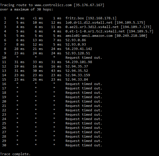

Since today the connection to controlicz is out again. (i did an unlink and link again)
The error message is:Couldn't update the setting. Check your connection.
With trace it seems that the server is hard to reach (From the Netherlands with the best provider XS4ALL)
It might be problems at AWS.

Hey :)
Controlicz is definitely up - it was down for very short periods whilst I deployed some code changes. It's possible that coincided with your test (but downtime is <10 seconds per deployment).
if it's any consolation, I can't ping or traceroute to it either - frankly i'm happy about that.
