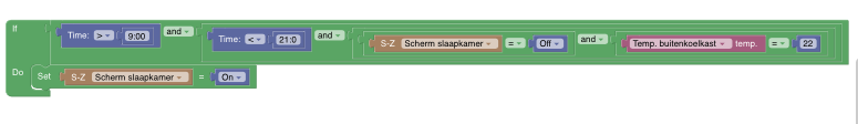

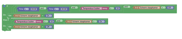

I try to link my sunscreen (' scherm slaapkamer' ) to a sensor value (' temperatuur buiten' ). I want my sunscreen to go down above 22 degrees (if it is not already down) and only during the day within a certain time. I made this blocky:
This should work, however, he does not. What am I doing wrong now?

Remko2000,
Would you try to set the time to OR instead of AND because it can never be 9 and 21.
Hope this will do the job.

I think the time setting is correct. It says > 09:00 and < 21:00, so for example 10:34 is > 09:00 and < 21:00. If you change the AND to OR, it will always be true, because any time after 09:00 will be > 09:00 and any time before 09:00 will be < 21:00.

Just a thought:- When you look in the "current states", does the "scherm slaapkamer" report as on or off, or maybe "Open or Close"?

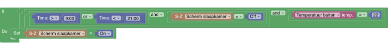

I changed the and to or but no improvement. The current states are on or off. This is no my blocky:

I assume you are from the Netherlands (or Belgium) you can delete the time > 9:00. I don't think it will be 22 degrees between 0:00 and 09:00. Please do check the Show current states to see if it really is on/off and not open/closed.

In the log it is on/off but in the current state its open/close. So I changed it to open/close now in my blocky. In the log I see:

@remko2000 the and blocks are stacked the wrong way around, if you stack in the second box of the and box and not in the first as you did here it will have a better chance of working. had this problem myself and that was the solution for me

Ok I've changed the stacked blocks, it's now:
Is this better?

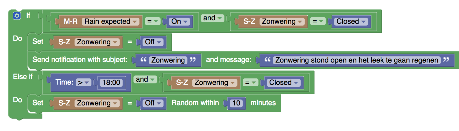

i have it already working like the picture below.
i only have the problem i now get every minute or every 10 minutes the notification. is there someone who knows the reason of that?
my theorie it is because the temperature is also changing?

@gerardsoraya, make an extra check on the screens. In the If statement add the line with temperature with an AND statement in which you check if the screens are open. And in de Else if statement add the check if the screens are closed. This should prevent receiving extra messages.

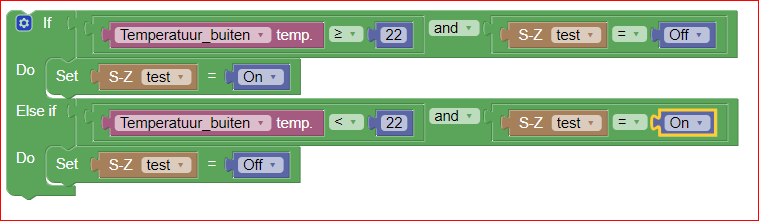

This is now my blocky but it still doesn' t work. I've tried many variations but still no solution. Anyone?

I wish I could tell you what is wrong but I don't. What about if you try to keep it simple. Delete the time part. Just use the temperature and the status of the bedroom screen (scherm slaapkamer).
What if you try:
(replace test with scherm slaapkamer)
What if you try:

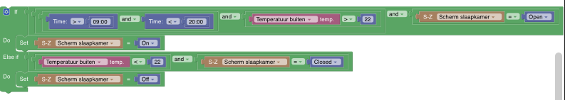

I had something strange in a similar situation. In the picture you can see my working solution.
Somehow open/close needs to be switched with on/off, but conditional states needs to use open/close. Maybe a bug?

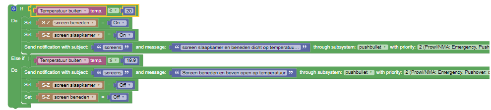

I made the blockly as i onderstanded the way you have said, the notification keeps on sending every 10 minutes.Eddiever wrote:@gerardsoraya, make an extra check on the screens. In the If statement add the line with temperature with an AND statement in which you check if the screens are open. And in de Else if statement add the check if the screens are closed. This should prevent receiving extra messages.

It seems that this blocky finally works:
I would likt to add a notification (prowl) but I don't want a message every 10 minutes. How can I prevent this?

So with the answer of remko2000, this seems to be a real issue. Does someone know where to do a bugreport or look up if this is already known?najtram wrote: Thursday 21 June 2018 12:21 Somehow open/close needs to be switched with on/off, but conditional states needs to use open/close. Maybe a bug?
