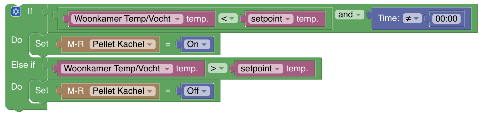

I created a virtual Sensor "thermostat setpoint" with "idx 94" and name "setpoint"
Now I want to transfer the value of the setpoint to a virtual "temperature" with "idx 95" and name "setpoint"
This, because I want to import the value from "idx 95" "setpoint" into a blocky input and compare this with a measured temperature in the living room "Woonkamer Temp/Vocht" to control the Pellet stove.
Example how I want to do this.
Schermafbeelding 2018-05-28 om 23.33.53.png (98.22 KiB) Viewed 2306 times

It's more easy to control the stove.
You have to make just a dummy virtual sensor and put in Thermostat Setpoint mode. Than you can blokly:
IF Woonkamer Temp/Vocht < Setpoint AND Pellet Kachel = Off
Set Pellet Kachel = ON
Else IF Woonkamer Temp/Vocht ≥ Setpoint AND Pellet Kachel = ON
Set Pellet Kachel = OFF

Hi, thanks a lot, it works now perfect
