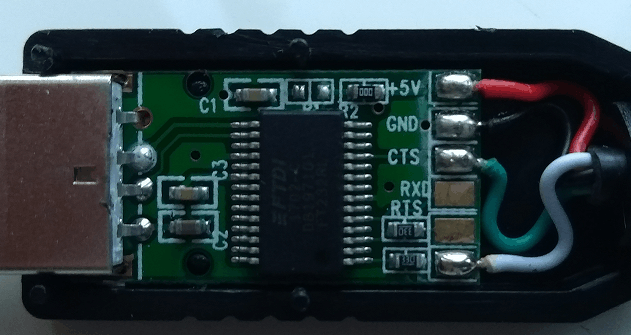

I got a ISKRA AM550 meter a little while ago and I bought a Serial converter with a FTDI chip embedded into the pcb, however I am not seeing any data. The manufacturer of the cable has put a 10k resistor between RXD and RTS.
Should I move the Resistor to be between RXD and +5v?
Kind regards,
EnderWolf
Edit: Found the problem, the RTS and RXD cables were incorrectly mapped, after swapping those back the cable is working.

Can you post a picture of the connections to the pcb? I think I've a similar cable, but it lacks a 10k resistor. So I hope I can mod this cable also to be able to read my ISKRA AM550. I've a picture of my cable:EnderWolf wrote: Sunday 13 May 2018 0:56 Hi,

I think I've to move the green cable from CTS to RTS and the white/grey one from RXD. I'm also unsure about the 10k resistor: place it between +5V and RXD or between RXD and RTS.
