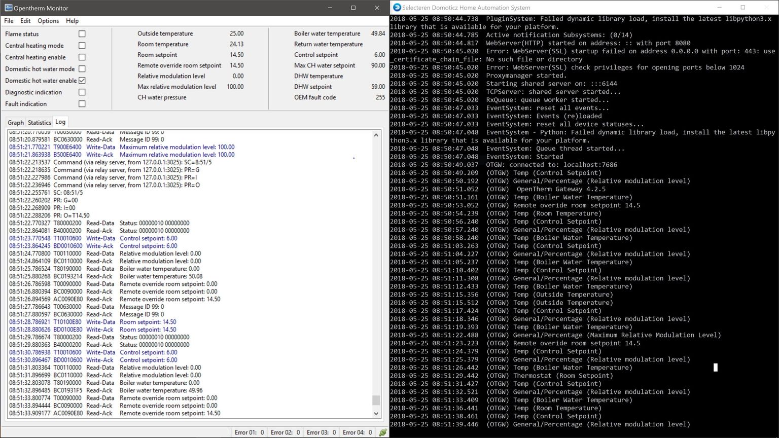

I attached a screenshot. I connected domoticz via otmanager so there is more to see. Oh forgot to say I changed the devices IDs of the switches and sensors in domoticz to the corresponding OpenTherm message IDs. So you need to delete the OTGW devices from domoticz. It will make new devices with the correct IDs.
https://imgur.com/a/eMJovpa
