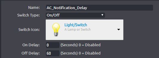

I wanted to delay messages, and have them not send if a device returns to the desired state within a set time.
I use dummy switches to trigger my script again after a delay, I do this as the switch can be configured to be momentary with a variable delay, this saves using and delays inside the script. I am also able to read the values of switches in Dashitcz, which I can't do with variables.
This is my switch (1 min Delay)
