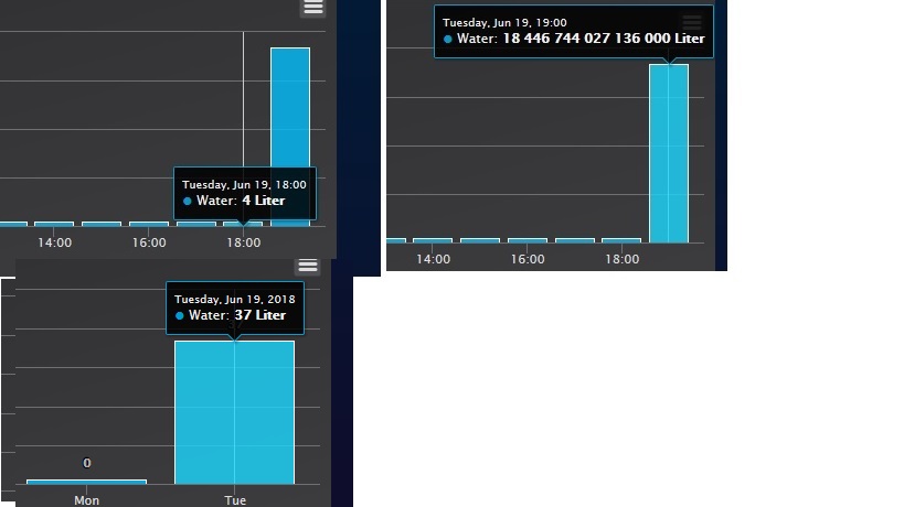

So I still need help with this and hopes that someone can help me. I have changed the code in my MySensors node and now no longer send 0 for water volume when I end the session Thought I got it, but no.
In the picture attached you can see that I filled 4 liters during 18:00, I then waited to after 19:00 and filled 2 liters more. The water volume widget shows the right values, but the 24-hour history is all messed up as you can see.
Also worth noting that a few hours earlier, though with old code in the node, I filled 37 litres. Not visible in the 24-hour view, but visible in the Week view? Also strange, why did it disappear from 24-hour view? And why isn't the 4 litres added to the week view?
Any suggestions to why this happen and what to do about it would be appreciated.

Domoticz work with the default mysensors water meter example, in fact, i work with it
"When the valve is open I can see the m3 value increase, and when the valve is closed I send one zero value to indicate the end of the session. m3 then returns to zero. I don’t know if that is wrong behaviour?"
Sure it is a problem, it is a counter... and should always increase
If you follow the JSON wiki how to update a water meter and look at the water meter mysensors example , you should get this working
Also fetch the last meter value from domoticz like in the example
