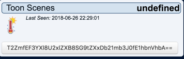

After upgrading Domoticz Version 4.9700 (June 23th 2018) two Toon icons does not work anymore.
1: Toon Scenes
2: Toon Autoprogram
The attachment 2.jpg is no longer available
The two icons shows text in it:
I don't now how to fix it or where the issue is, this happend after the update of Domototicz 4.9700 before it works super.

Post by gizmocuz »
Try editing your switch and label them correctly. (i assume you cleared the browser cache and appcache)

OMG :oops:
Thanks for your help now it works..
