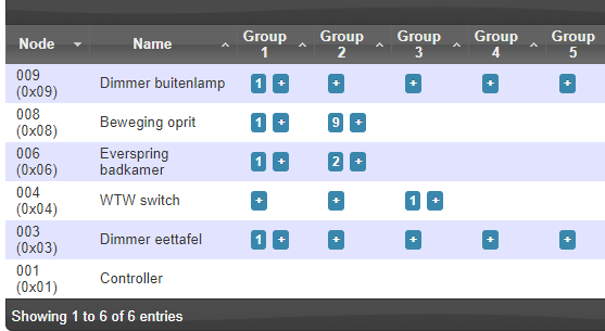

node setup (node 4 is the relay unit):
Groups setup:
