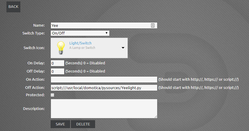

Look for a solution with os.execute (described in the wiki) Here
Or create a Python script using the package described here and call that from a device's off and/or on action
you could do whatever action is possible with your yeelight bulbs.
python code to dim to zero in 15 seconds.. // Script needs Yeelight module; install with ==>> pip install Yeelight
#!/usr/bin/python
from yeelight import discover_bulbs
from yeelight import Bulb
bulb = Bulb("nnn.nnn.nnn.nnn", effect="smooth", duration=15000) # 15 seconds
bulb.turn_off()Debian buster, bullseye on RPI-4, Intel NUC.

Yes but you will have to use the os.execute command
