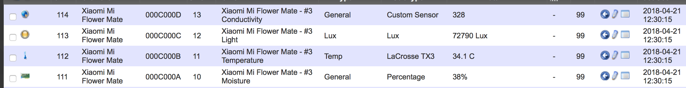

We have a working setup, let's write some script to connect with Domoticz.
Create dummy devices for each sensors. I have these per sensor:
Screen Shot 2018-04-21 at 12.37.52.png (174.25 KiB) Viewed 3772 times
Put these scripts in the folder above miflora-0.4.
