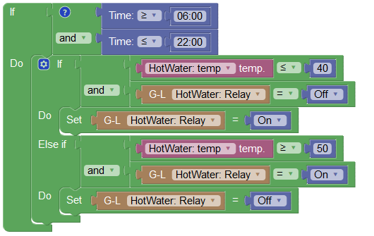

Hello i have SONOFF TH16 and connect my boiler for hotwater
and i need to control temperature at day and night for economy electricity.
but blocky not work correct and run on or off every minute. and i think not run when i need on rule.
can we help with script

Kre10, some remarks:
- Nested IF is not allowed (remove the outer IF)
- Use the IF with the blue star when ELSE is involved (correct for your inner IF)
- use a Dummy Switch Device and let it switch ON at 6 and switch OFF at 22hr (with the Timer of the device)
- combine this Dummy Switch in the IF part and in the ELSEIF part
- make sure the Blockly is of the type "Devices"
No need for scripts !

I think this is the right way with blockly:
If Time ≥ 06:00 And Time ≤ 21:59 And HotWater: temp ≤ 40 And HotWater: Relay = Off
Set HotWater: Relay = On
Else If Time ≥ 06:00 And Time ≤ 21:59 And HotWater: temp ≥ 50 And HotWater: Relay = On
Set HotWater: Relay = Off
Else If Time ≥ 22:00 And Time ≤ 05:59 And HotWater: temp ≤ 70 And HotWater: Relay = Off
Else If Time ≥ 22:00 And Time ≤ 05:59 And HotWater: temp ≥ 70 And HotWater: Relay = On
