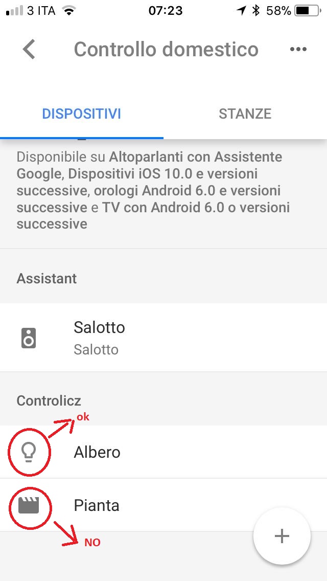

finally google assistant speaks Italian.
I immediately tried controlicz and it works well.
but I have a problem:
I can only control "switch" devices.
I can not control "scenes" or "groups" even if I view them
when "I call" the scene ("ok google, accendi pianta") he searches on google.
(example in photo)
I tried to rename Domoticz, I tried to add the description (Controlicz: <friendlyname>) but nothing. does not work.
google understands the names, because I did some tests, but it seems that it does not accept the "scene".
How can I fix this problem? for me it is very important
thank you
sorry for my english

- example assistant 2
- WhatsApp Image 2018-04-09 at 07.28.47.jpeg (88.03 KiB) Viewed 3422 times

Hi vchecco, I'm Italian as well... and for what I know, scenes are not currently supported by Google Home in Italian.vchecco wrote: Monday 09 April 2018 14:50 finally google assistant speaks Italian.

I think we need to wait for the native support, hoping it will come soon.

Have had confirmation from Google - not supported yet
