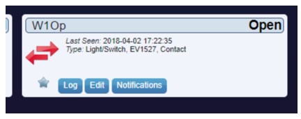

Here is the device in Switches: set up as a contact, light/switch, ev1527
