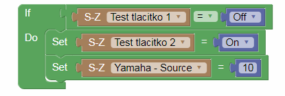

I'm newbie and I'd like ask to help. I create two test buttons "Test tlacitko 1" and "Test tlacitko 2" and I'd like to change the Yamaha Source to "HDMI 1" after click the button.
And I'm not sure if the condition is write correctly. But after I click the button nothing hapend.
Please could anyone help me? Thanks
