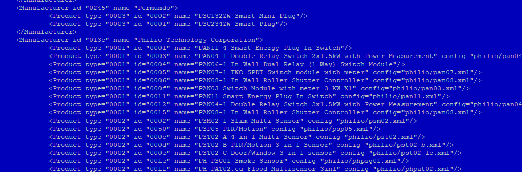

in the Folder usr/local/domoticz/config/manufacturer_specifications.xml i See the Philio Switch PAN06.
But the xml from the switch is not in the config folder of the manufacturer.. ist this the problem that i cant include the switch?
