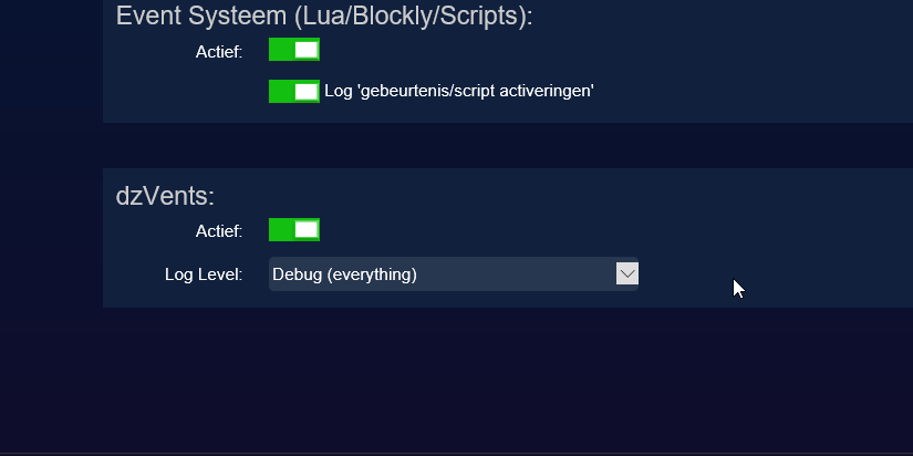

Where did you switched on the debug? It does not look strange
Greetings McMelloW

did set it to device..

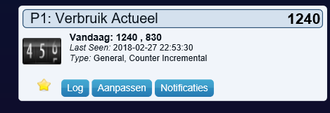

Only stil have empty counters:
Or wrong data:
Hope you can set this to actual or something :-)
I changed this in the settings page:

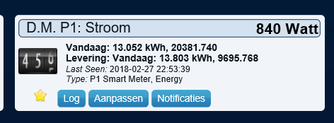

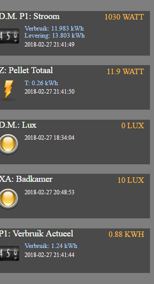

mmm
Looks there is some strange data change:
Actual is not in the upper right corner
Ps: The 10watt different is the time between the screendump
Perhaps a other counter??

leave the settings in setup for dzVents to errors + minimal execution errors
In the script remove the 2 dashes -- of line 19 for the logging.
In the log set the filter to SME
Greetings McMelloW

Derik wrote: Tuesday 27 February 2018 22:55 mmm
There is also 9 sec. difference in the updates. In that case 10 Watts is not strange.
Greetings McMelloW

Only you think it is ok now?
Only the actual use in the upper right of your script device. is not the same as actual use in the upper right of the P1
Or is there by me something wrong?
