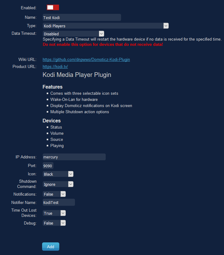

Update pushed to Domoticz to allow plugin authors to include guidance to users on plugin configuration or to just communicate what the plugin does.
The optional <description> tag in the plugin definition is now sent to the browser in the Hardware page and displayed as HTML.
For example:
<plugin key="Kodi" name="Kodi Players" author="dnpwwo" version="2.4.1" wikilink="https://github.com/dnpwwo/Domoticz-Kodi-Plugin" externallink="https://kodi.tv/">
    <description>
		<h2>Kodi Media Player Plugin</h2><br/>
		<h3>Features</h3>
		<ul style="list-style-type:square">
			<li>Comes with three selectable icon sets</li>
			<li>Display Domoticz notifications on Kodi screen</li>
			<li>Multiple Shutdown action options</li>
		</ul>
		<h3>Devices</h3>
			<li>Status</li>
			<li>Volume</li>
			<li>Source</li>
			<li>Playing</li>
		</ul>
    </description>
    <params>
will now look like this:

tried to use without success.
Can you spot an error to my code regarding description?
https://github.com/ycahome/pp-manager/b ... /plugin.py

@ycahome,
Assuming you are running a current beta you definition looks fine.
There was a change to the Hardware page itself, did you refresh your browser cache?

Post by ycahome »
@Dnpwwo
You are right but, requires not just a refresh but a clear cache/Delete Browser Data (depends on browser).
