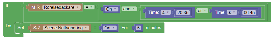

I am trying to create my first Blockly script, that I want to control a light scheme (Philips Hue) when movement is detected by a simple 433 mhz motion detector. It should only activate between 20:35 and 06:45.
WHAT am I doing wrong? I have redone this script 45 times, so if this result looks like complete bulls*it, my explanation is that I have re done it so many time that it broke.. :lol:

Try:-
If [(Rorel....... = On) and (Time >= 20:35 Or Time <= 06:45)]
Note that you also have the second time set to greater, rather than less.

Hi, you can change to this diagram:
If (Motion =on) and ( Time >XX or Time < XX)

Start with the AND block

Will this help?
The lower example uses "External Inputs" on the And block, which I find easier to understand. That's just a personal choice though. :)

StanHD wrote:Try:-
Haha, that's what I meant when I said I scripted it to s*it! I tried so many combinations not knowing what I was doing that it eventually broke.
StanHD wrote:Will this help?
This does indeed help! It's working now!
