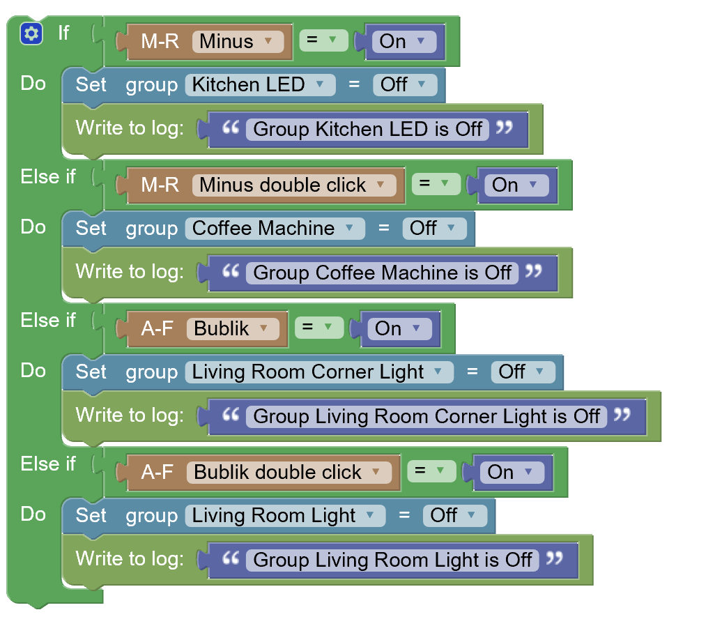

After I have upgraded Domoticz to v3.8924 I have a problem with blockly scripts.
When I switch on and off the kitchen LED, the following is shown in the log:

EventSystem is repeated about 20 times! With the previous beta I did not have such an issue.
Any ideas please? Blockly is attached.

I have this problem too in 3.8922. I wasn't aware I downloaded a beta, I'll think I'll go back to the latest stable.
When I switch something on or off, it works fine. But when I use a group Domoticz switches random things on or off and keeps doing that until I down and up it. I run on Ubuntu 16.04.

I noticed this too when i updated to 8926 today.
Try changing the drop-down on the right hand side of the Blocky to device.
This resolved it for me.
